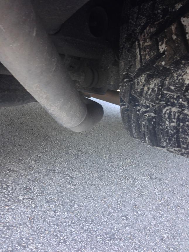

Here is a clear pic on the distance from the exhaust pipes.
Thank you!!! That's awesome.

Gents - I am curious - in removing the heat shields from around the exhaust - I've always wondered - is their function really all that important, other than protecting the spare from melting? I didn't get the comment about having an air conditioned trunk area. Does removing it cause the cargo area to get hot inside the cabin?

I'm sure it is relevant as nothing gets added to a vehicle without cost consciousness during the design. I would/will wrap the exhaust to achieve the same effect.

I got out and felt the spare near the exhaust after some longer drives. The tire doesnt get anywhere near hot enough to damage the tire IMO.
I was going to get a thermal IR gauge to measure it, but haven't gotten around to it yet.
I was worried about removing the shield also, but at this point I can't figure out why it is needed. I am sure it does block more heat but I think with the spacing there and the air moving around, its going to be hard to mess up the spare.
Sitting idle for a long time might be a more abusive test.
