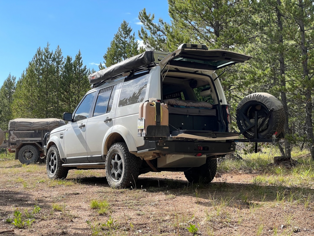

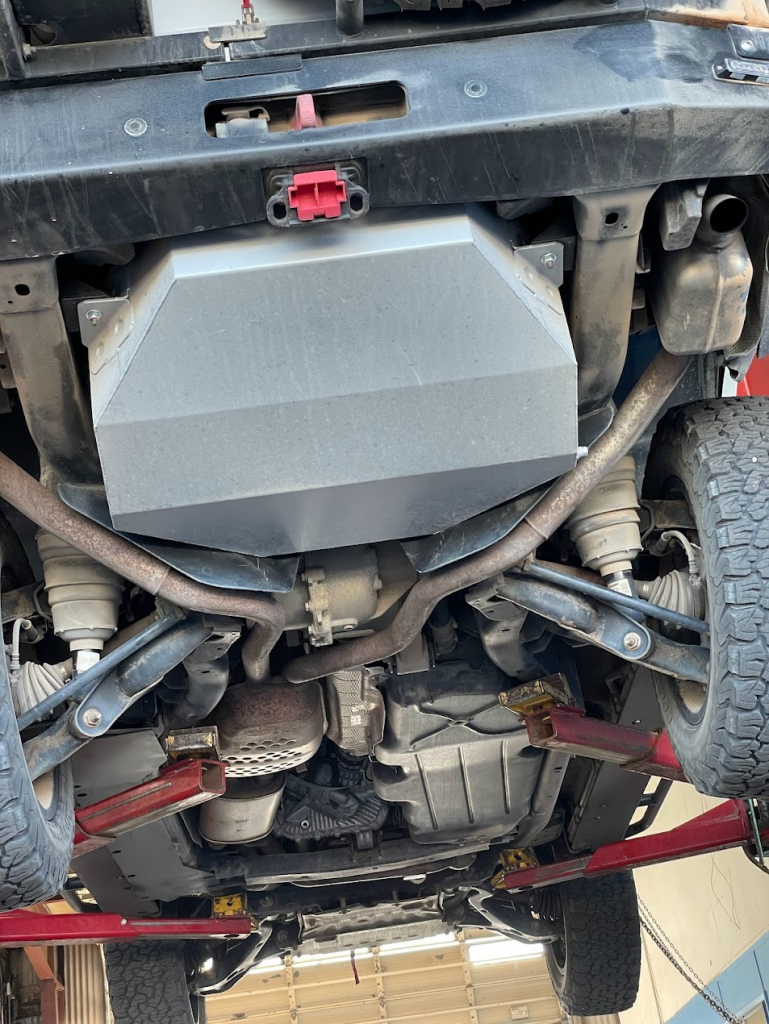

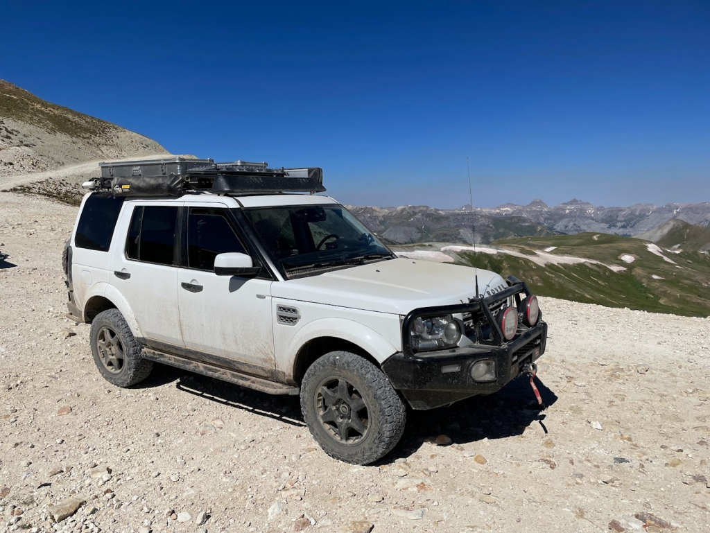

just saw this thread pop up. FYI.. the Long Range America 28 gallon aux fuel tank is now available in the U.S. with some new tweaks to the fuel filler hose/pipe that allows it to fit without fabrication work. Makes the install a bit easier. Me and a buddy installed it over a couple days (and we were using prototype pipes and giving LRA feedback on it). If you are interested I think you can get a discount with "IOWALR4" which is my instagram name.
I just did about 2,200 off road miles of the continental divide overland route. The tank is tucked up really well, I don't think I touched it more than one time and its built for it so I am not worried. Amazing having nearly 50 gallons of fuel. Others in the group had to use jerry cans to make the distances but I just hit the button to move fuel over. Well worth the money IMO.

Yep. Single best modification I have made to mine.
I can attest that the tank will take a lickin' and roll on. Mine has a couple of deep dents and several gouges from crawling over rocks.
I would be interested to see how they modded the fill system. Mine took a bit of fab and welding to get it sorted, but this was 5ish years ago. Actually had to import mine directly, pay customs, pick up at Port of Houston, etc.
Curious if yours ever throws a CEL? Mine will occasionally throw one for "vapor flow incorrect direction" or similar. Usually only when both tanks are filled to the brim. Never a performance issue, so just clear with IID and drive on.

That is a nice rig. What do you think about the rear locker? I'm curious about the auxiliary tank. This might be a long shot but is it designed in such a way that you could draw from it to fill a generator? I'm planning to overland in my '12 but I have 2 5 Wavian cans that I use. It would be sweet to get rid of the cans saving precious cargo space and keep the weight from the gas down low.
