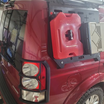

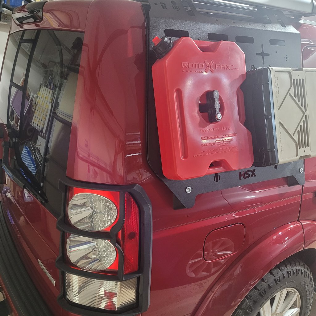

Rover Range brings a good point that scares me: if I'm in the hills on a low tank, at what point do I risk running the pump dry and stalling? Almost happened to me on the Smoor Overlanding Rally, so I installed an Idiot buffer buffer!
