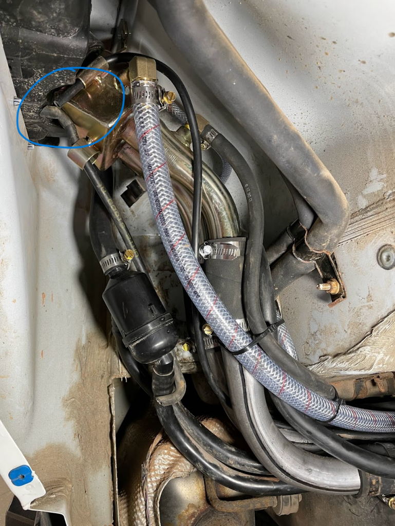

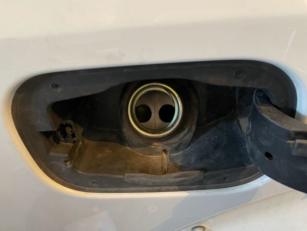

I don't see any reason why you couldn't syphon fuel from the aux tank directly from the fill point. Its a straight hose down into the tank. The pump is another line from the tank into the main tank side of the dual filler assembly, so nothing in the way of the large fill pipe going into (or out of) the aux tank side.
I've never had issues with the evap/emissions system or throwing codes. The system functions exactly as it did before with one pressurized air volume that just includes the aux tank after install. The fuel filler cap seals up the system just as before. There are plenty of connections though to make sure you have sealed or that could give codes, but the system won't have any idea you added this aux system.

The new pipe goes from the dual filler assembly to the factory metal fill pipe. Each end of the new adapter pipe is a different size to account for the different ends. Makes it as simple as having those two short rubber hose sections to connect it all up. That solves all the pipe cutting and fab you had to do before and reduces the number of joints/connections.
The kit comes with all the hoses, clamps, everything, so no pipe cutting, no hose cutting, its just about hooking it all up and they provide diagrams of where it all goes.

Thank you for sharing the photos. I was wondering how the fill ports were arranged and your first photo answers that...now I see what you mean about how the fuel filler cap seals up the system just as before.
