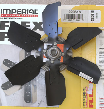

Hey Joey, Do you have metal fan? Or know one that will work? Or does anybody know one that will work? Thanks Charles :confused:

Go with a standard replacement, it will work well, and cost less then converting over to metal. Plus you stand the chance of loosing horse power and or getting worse mileage with a fan that has a higher rated air flow.

Well I got a fan clutch and metal fan from Auto Zone. Seems to work good, but is a little loud. The fan clutch was $52.00 and the fan was $24.00. If this works out I may still be able to afford a skid plate soon. I was all set to get one when this happened. It always seems to work out that way. Charles :wink:

Here is the pic of the fan with clutch that I have been told will work, no I have not used it. Personnally in the fall, winter, and spring I don't run a fan. And I hope by next summer to have my Dual electric fan installed...
It is a Hayden Fan Part # 220618

Thats the one I got. It works so far. Just drove it about 15 miles tonight. Charles

Charles - works as in - same/better/acceptable? I.e what temp. sensor says? Noise level i presume shall be higher though - seeing it got less blades than stock one and they are in regular pattern.

The temp gauge has stayed the same. It is louder, but not overbearing. I have not driven it much and only in the late evening. I am going to Richland Gap N.C. on a ride next weekend, so we will find out how well it cools. Charles
