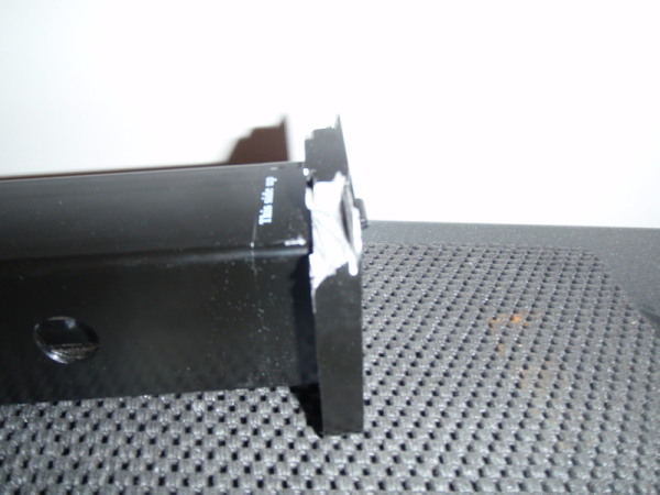

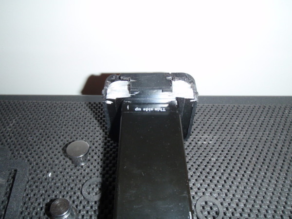

I figured out a way to make the Hitch Safe work. It involved a Dremel tool, paint, and longer pins which are available online. I will post pics tomorrow......

I cut out part of the collar so it would accommodate the angle of the hitch. It took some cutting w/ my Dremel. I also had to cut the rubber cap which had some metal in it for rigidity. This way, you do not have to cut new holes for alignment. This is not he finished product - which is painted and smoothed over a bit. When attached, it looks stock. Excuse the rough cuts as I am not a master of the Dremel tool. I will post finished pics tomorrow.

Hey, thanks for the pics, and way to get aggro with the power tools. Beats my hand-file fix, which means, I still have to mount in backwards.
