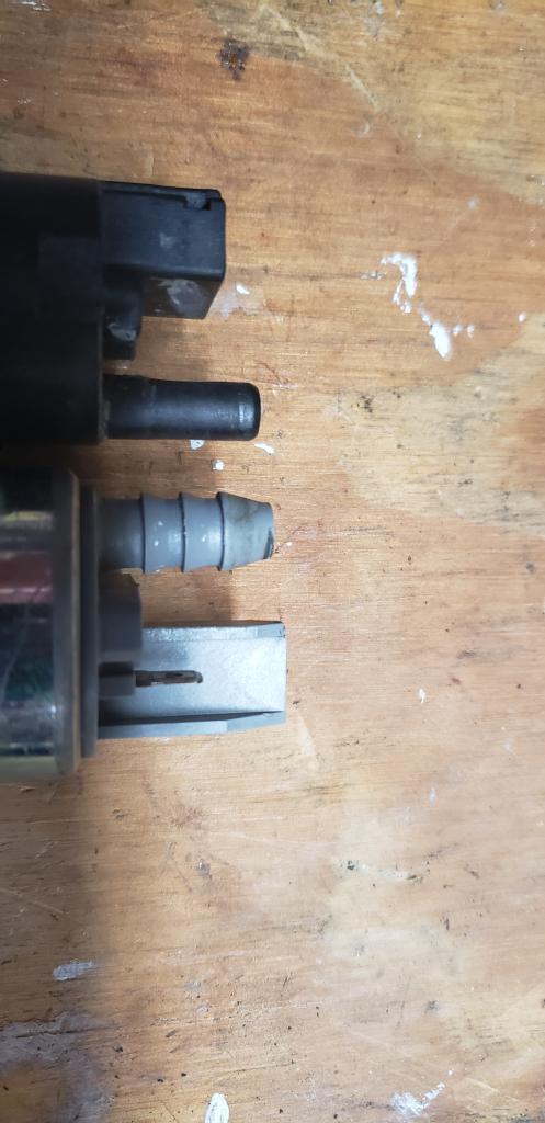

I had watched that video before and tried the pump only replacement he did but the ****** size of the replacement unit did not match my connectors and I returned it and bought the aftermarket Beck/Arnley complete assembly. Below is the pic I sent the company showing the different ****** size.
