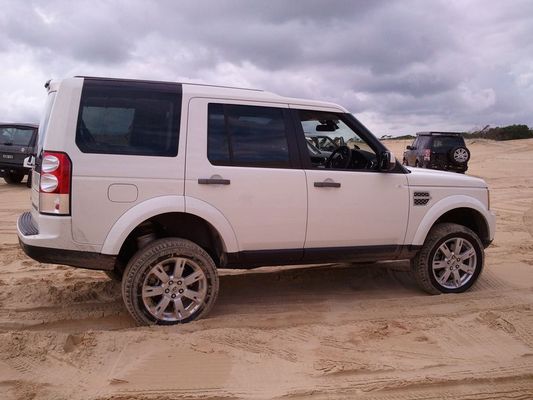

It says it can detect when it has bottomed out and only then is when it is available. Need to keep the foot on the brake and hold the EAS height button up for a few seconds. Sand or mud is the easiest way to test it, although I heard there are ticks to do it with a jack.
Here's a pic from the web of an LR4 in super extended (IID Tool makes it even higher):

So to learn how it works I need to get stuck. Oh, wait, you did that for me. I guess its all a matter of trust. I hope I never need it.

Put a jack stand flush under the jacking point on the chassis rail and lower the car to access height if you want to see Extended Height in action, and then you can invoke super-extended as explained above (hold the brake pedal and suspensions "Up" button pressed for 4-5 seconds.) As a matter of fact, quite a few LR3/4 owners in our local club carry a jack stand with them specifically for that reason when we go off-road, so they can force extended height before taking on obstacles where they may get high centered. You do gain an extra 2.5-3" of additional clearance in that mode, so not trivial.
