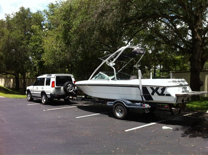

We just got a 2010 LR4 HSE LUX and will be towing a 2006 Mastercraft X1 with it. My 04 Disco SE did it just fine, so im sure my LR4 will be even better.
The boat weights 3200lbs dry, so add about 1000lbs more of amps / spakers / subs / gear / lead. and about 1200lbs for the trailer with brakes.
Here is the disco loaded up... she did sag a bit, but im sure i could have resolved that with a different hitch.
Ill be posting a pic of the new LR4 with the boat ASAP...
