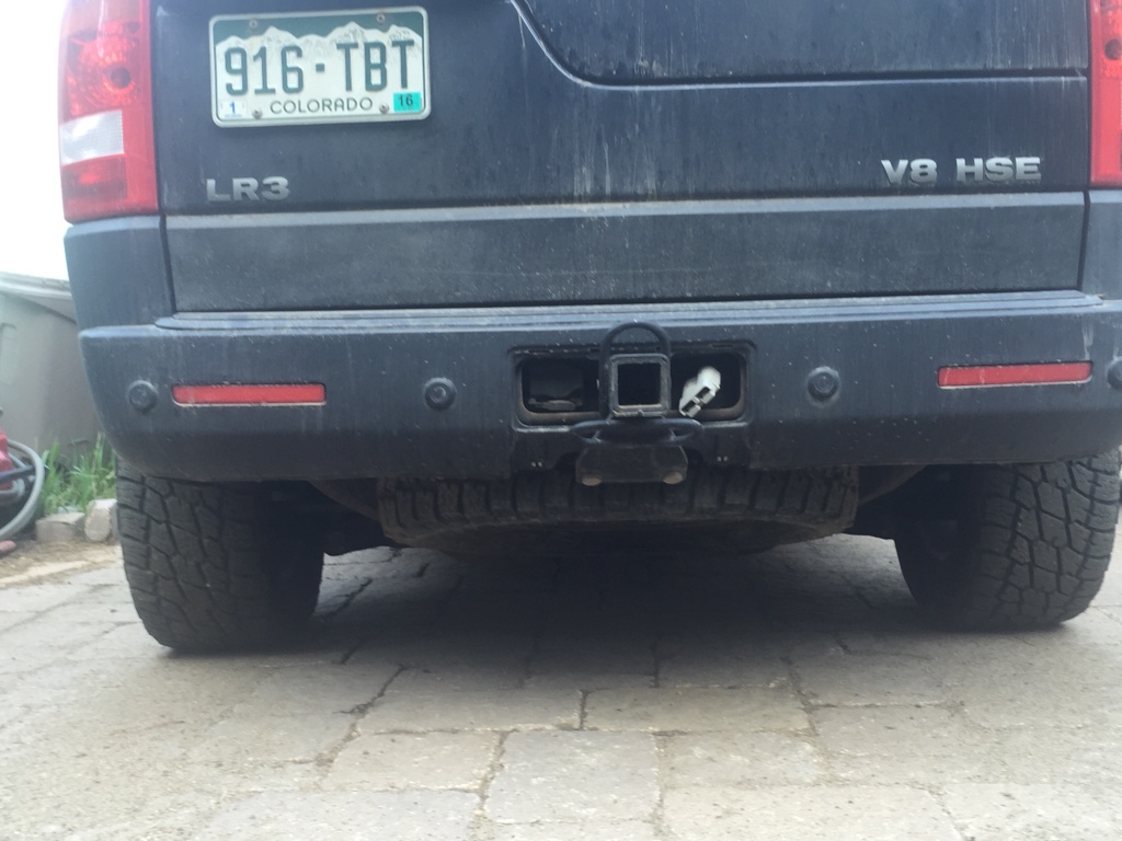

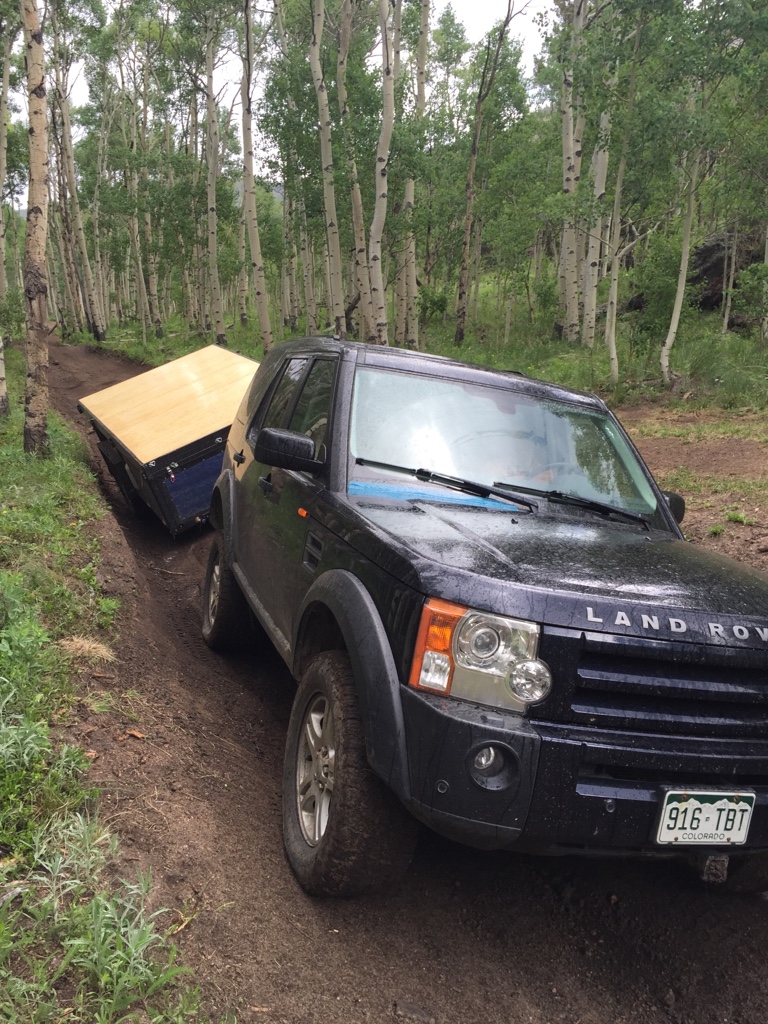

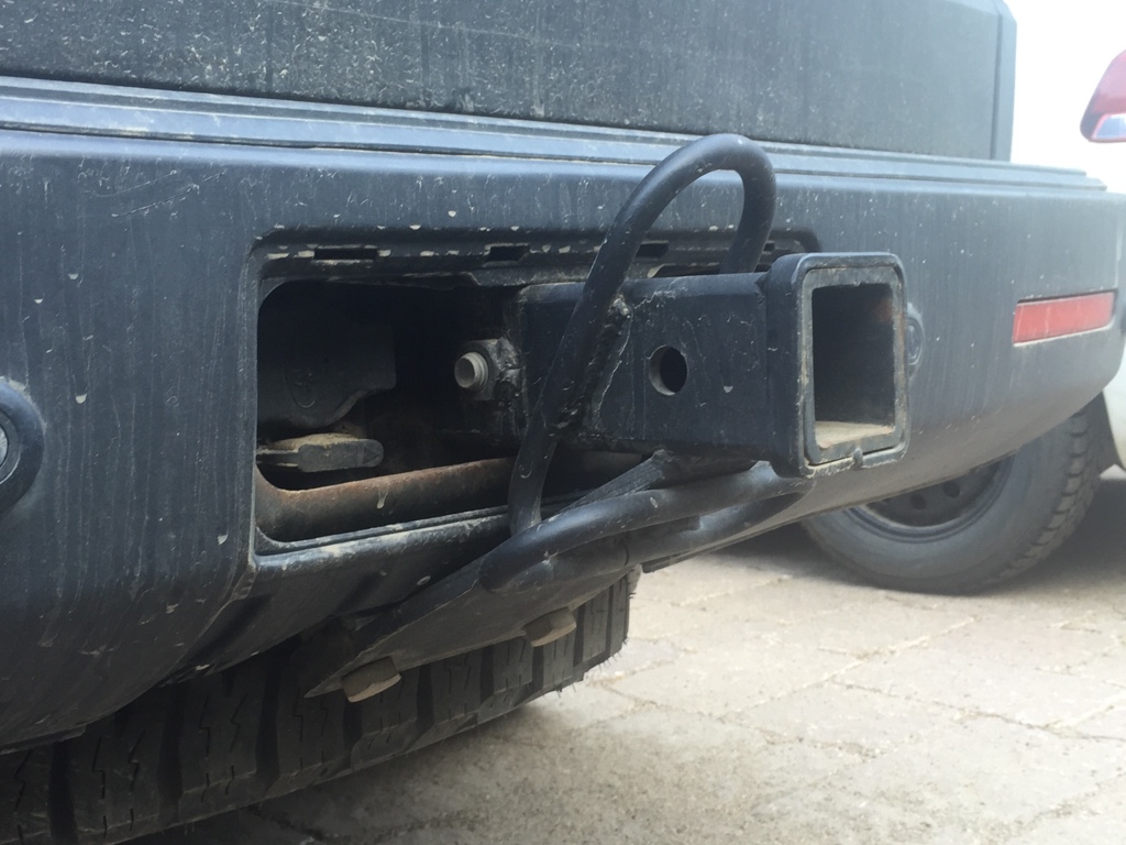

Here is my solution that I built myself. It bolted trough the recovery loop with a tapered pin to secure it tight to the bumper and through the holes at the bottom as well. I attach a receiver mounted winch to it with no issues I have also lifted the entire rear end of the truck using it to lift from. I tow an off-road trailer with it but I haven't done any heavy trailers yet.
Nice! That looks very well done. Maybe the safety chain loops should be revisited to be sure they can carry the weight of the tongue if necessary.
It looks to me like just the two welds would be doing all thew work in that event. What do you think?

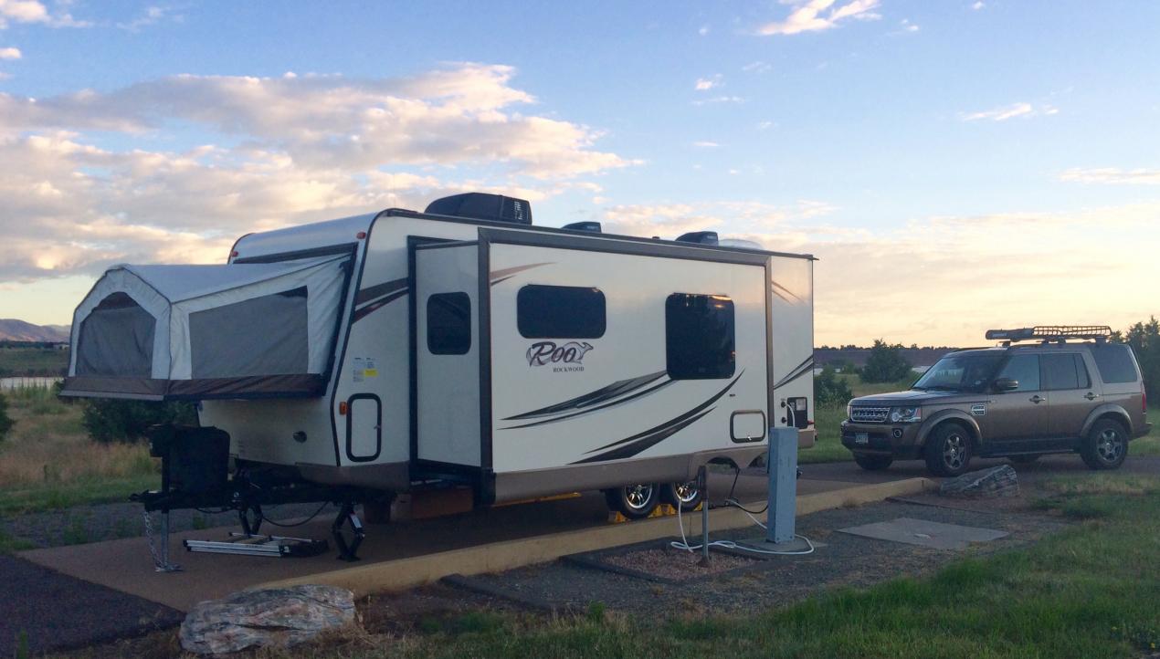

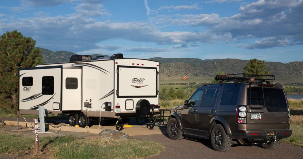

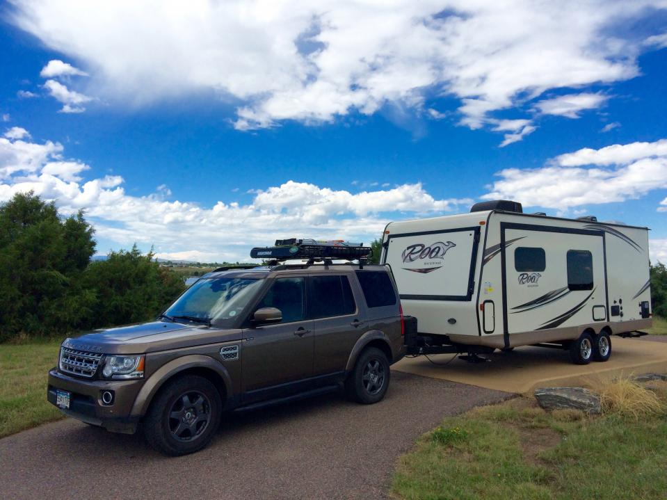

That is pretty cool! Range Rover Autobiography and an Airstream. (Though I'm not an Airstream fan they are certainly an icon.)
Our trailer is about the same weight. Maybe a bit less. 2' less in length. But nearly 3' higher in height and presents a big, flat front to the wind!
I opted not to go with the OEM hitch. When I pushed my service folks about a "gen 3 hitch" they knew nothing of it and would not stray from the lower tongue weight rating. I also am going to use a Hensley towing system which, in part, provides a weight distribution system and the LR documentation fussed about weight distribution hitches. So I went with the Curt bolt on. I can always take it off if things change.
I haven't towed in the mountains yet (I've only had the trailer 5 days) and I don't have the Hensley on. When I do I'll try to remember to record some numbers and pass them along. (It would be nice to have the SDV8 that the Range Rover in the blog had!) My MY14 only has the SCV6. I plan to take it easy so we'll see how it goes. Some of our mountain passes here are over 11,000.
