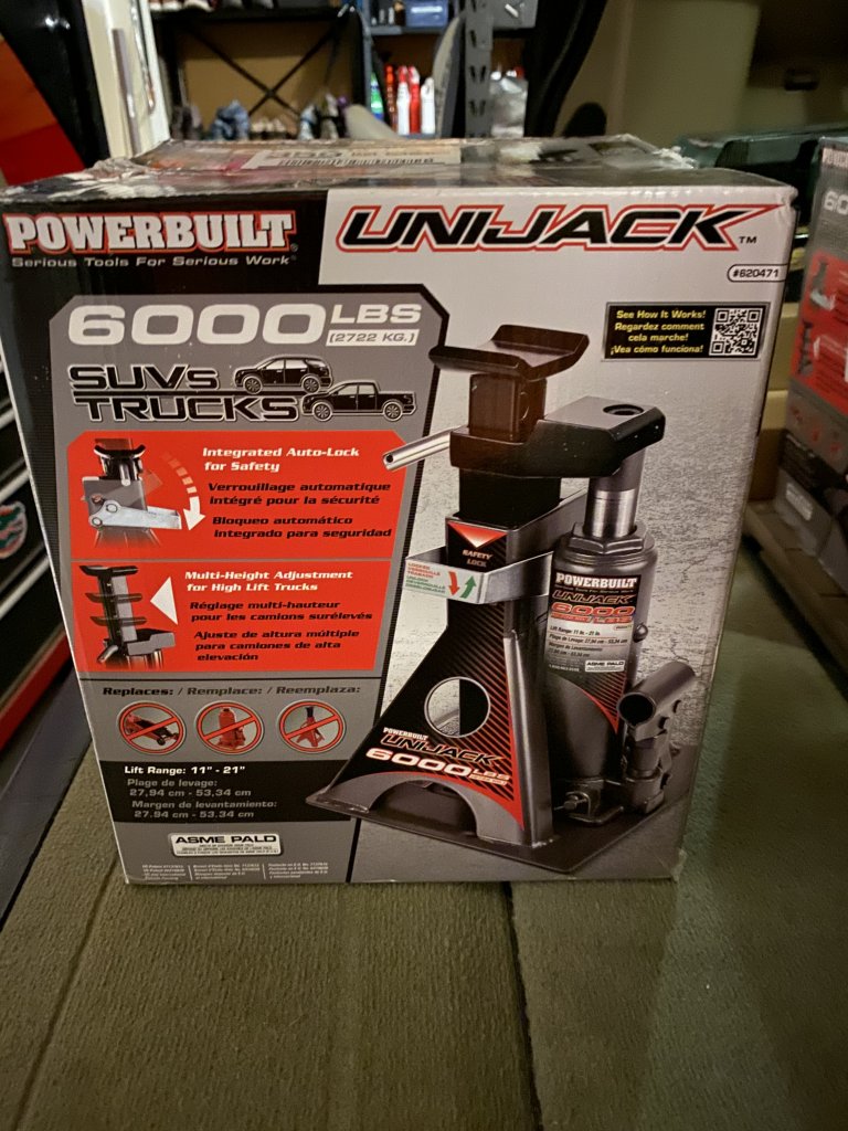

Just bought two of these and did a brake/rotor change with no problem. They are a bottle jack/jack stand all-in-one. Unijack at Mernards.
