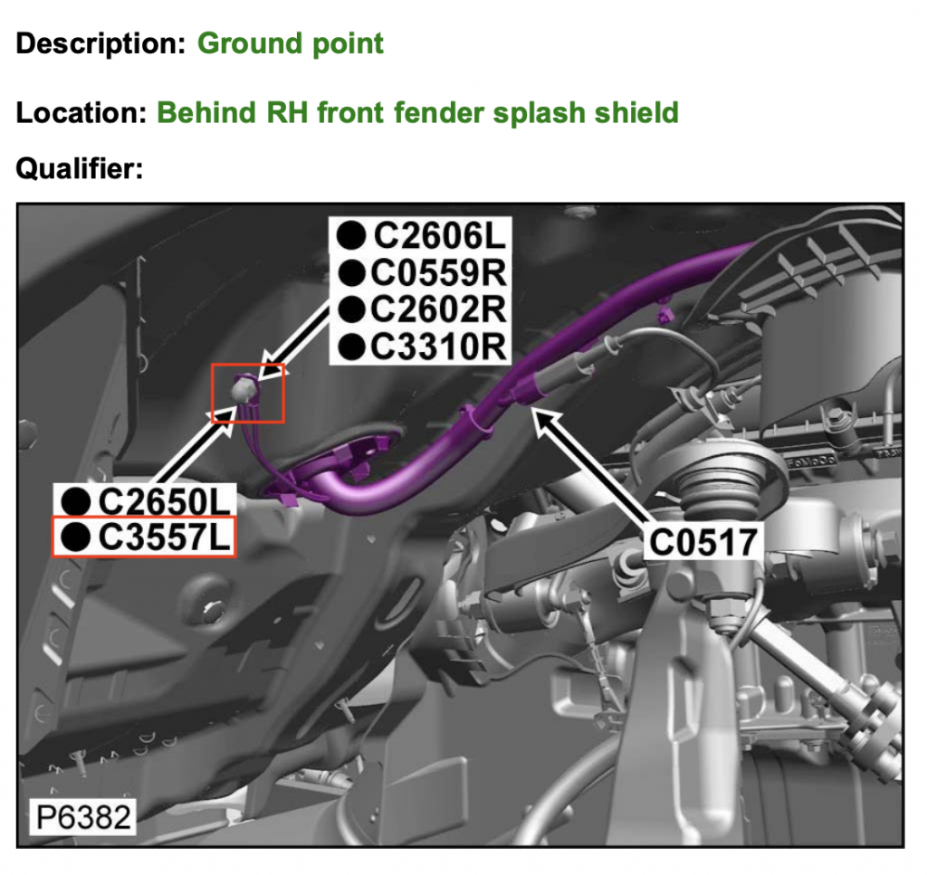

Here is the ground for the ECM (C3557L), others have reported it should be checked frequently, I'll check mine tomorrow when I have access to the car again but in case you're bored it's probably smart to check and clean this ground anyways. The coils have their own ground on the engine but this one might be worth looking at

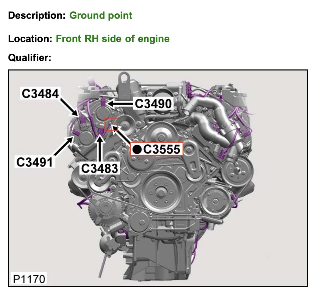

Where do the coils get grounded? I have leaky valve covers and a leaky passenger side upper timing cover and I’m wondering if this could mess with the coil grounds at all.
Adrien
Aug 22, 2019
48
21
Seattle, WA
See C3555, left and right banks appear to have their own grounds, mirrored on each side. I'm still trying to track down the main engine grounds as well. On other vehicles it usually looks like a metal belt but for the life of me can't find it on this engine.

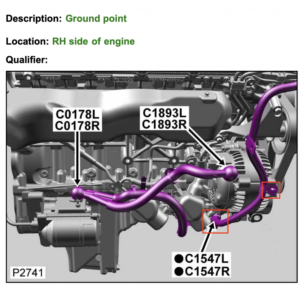

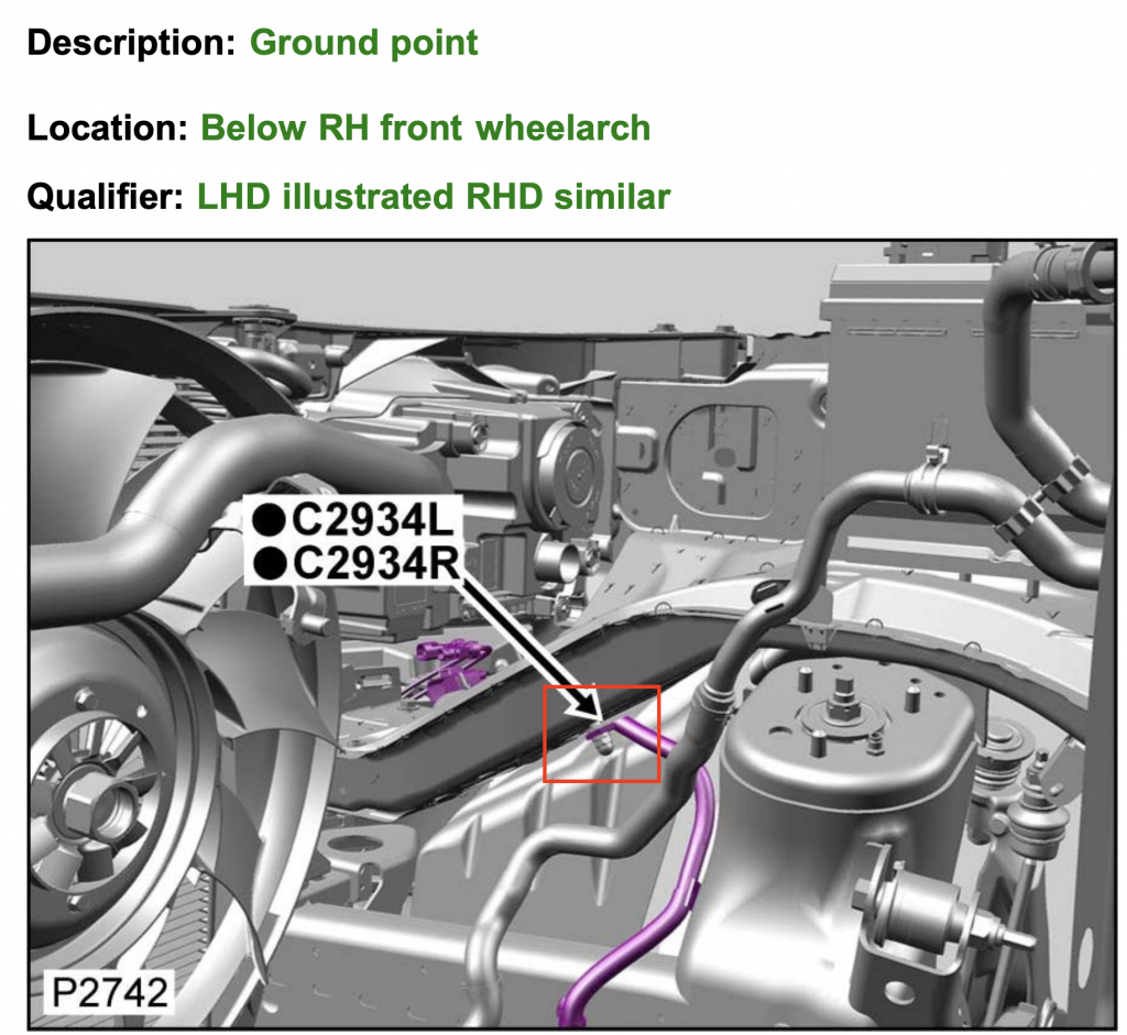

Located Ground/earth strap, same cable that grounds alternator directly. It's also located in the wheel well but forward (the image attached is from a weird perspective so it's hard to tell at first).Screenshot 2023-06-30 at 5.29.52 PM.pngScreenshot 2023-06-30 at 5.30.17 PM.png
