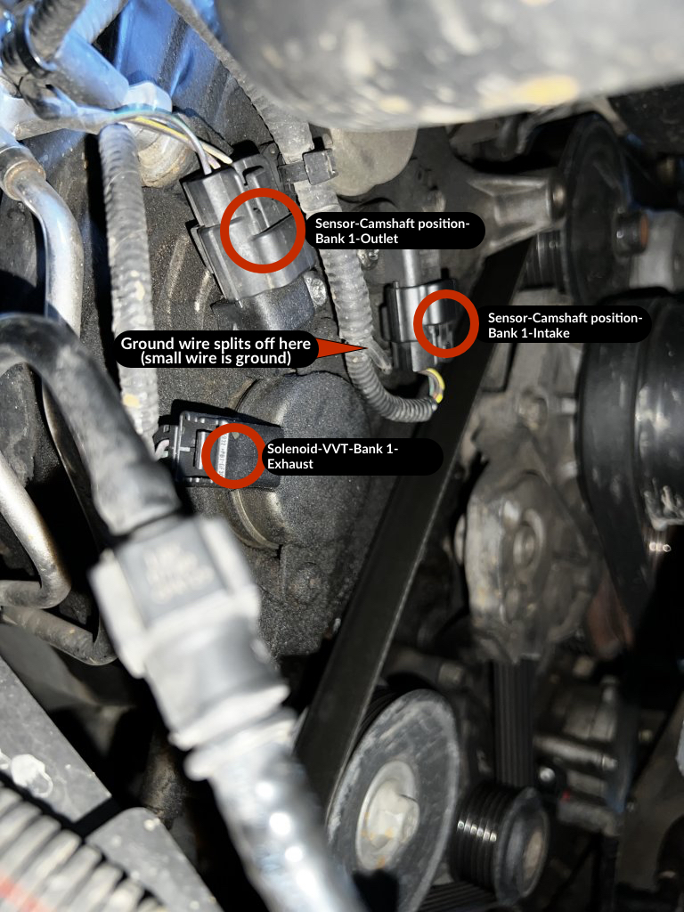

Definitely possible, my wet plastic is towards the rear of the engine however I will double check when I get back to the car on Friday!

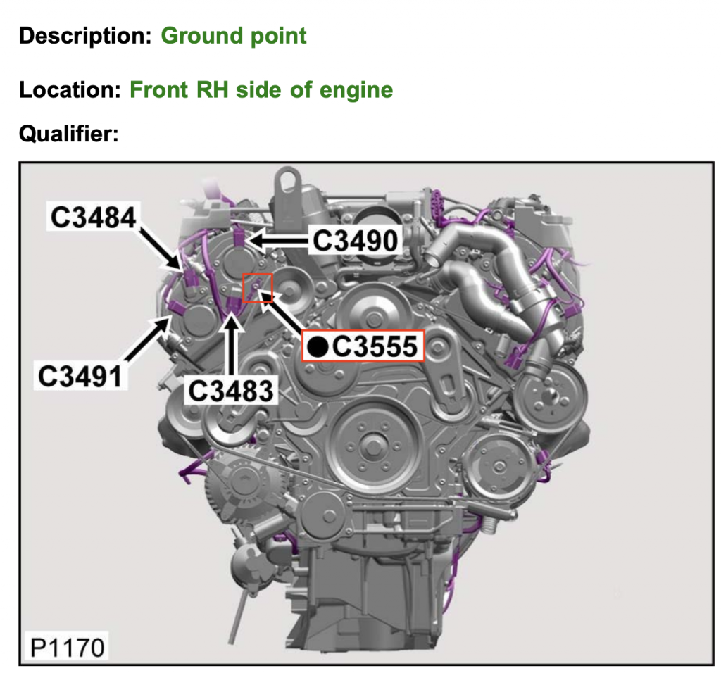

Assuming you checked those connectors on the timing cover? I forget if the cam position sensors are on the front or the rear. Wouldn’t explain the voltage issue but a faulty cam sensor could cause no spark.
The ground for the coil banks are in that area, so maybe if one bank isn’t grounded correctly it could cause issues with the whole circuit but that’s just my speculation
Ya I can see the ground to the coil banks in the photo and it’s covered in oil, that’s why I asked if yours was covered in oil as well. Ive had that oil leak for over 3ish years now and wouldn’t be surprised if it corroded that piece making the ground bad, I’ll clean it off and put a multimeter on that ground and on the battery to see if there is any resistance.

In other news I finally confirmed there is a single capacitor that feeds both banks of coils. I will supply wiring diagram shortly, I'm just having trouble finding it's physical location on the engine at the moment
