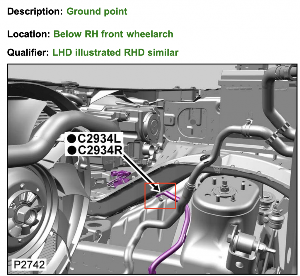

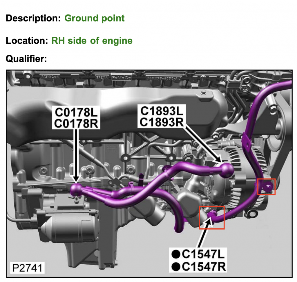

Located Ground/earth strap, same cable that grounds alternator directly. It's also located in the wheel well but forward (the image attached is from a weird perspective so it's hard to tell at first).View attachment 23517View attachment 23518
Also from this photo just trying to understand this illustration, is that a positive charge cable that goes from the alternator through the starter all the way up to the battery?
Since we’re both having issues with the car actually starting and weird voltage issues this cable links both of the 2, wouldn’t that be the issue??
Maybe I stared at this image for too long last night so don’t rip on me if that sounds irrational.
I want to say it's only ground that is shared between the two, but I'd have to go look at the engine in real life as those diagrams can start turning into Picasso paintings in my mind.

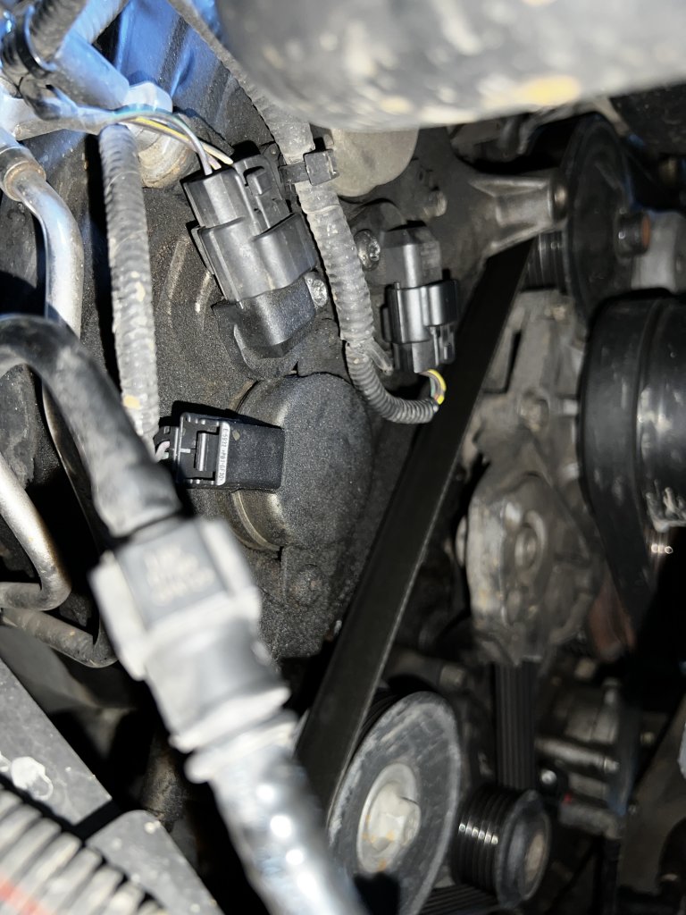

Hey buy chance, do you have a leaky upper timing cover/valve cover gasket that just covers your upper timing cover in oil?
I recall the plastic near the PCV looked like it might be a little wet, but have been so consumed by the cranking issue I haven’t paid it any attention. If you want to throw up a pic of your leak I can tell you if it looks similar

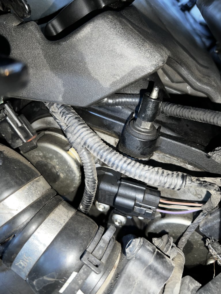

My passenger side is covered in oil but my driver’s side is fine. I’ve neglected this oil leak for a long time so my thought is couldn’t this have corroded the ground for the passenger side coils?
Definitely possible, my wet plastic is towards the rear of the engine however I will double check when I get back to the car on Friday!
Assuming you checked those connectors on the timing cover? I forget if the cam position sensors are on the front or the rear. Wouldn’t explain the voltage issue but a faulty cam sensor could cause no spark.
The ground for the coil banks are in that area, so maybe if one bank isn’t grounded correctly it could cause issues with the whole circuit but that’s just my speculation
