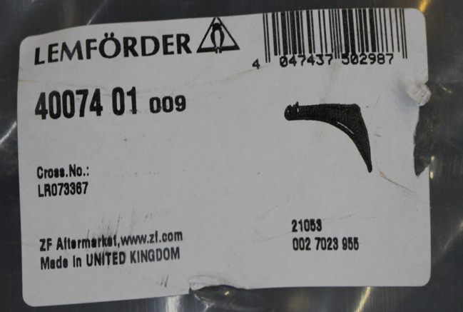

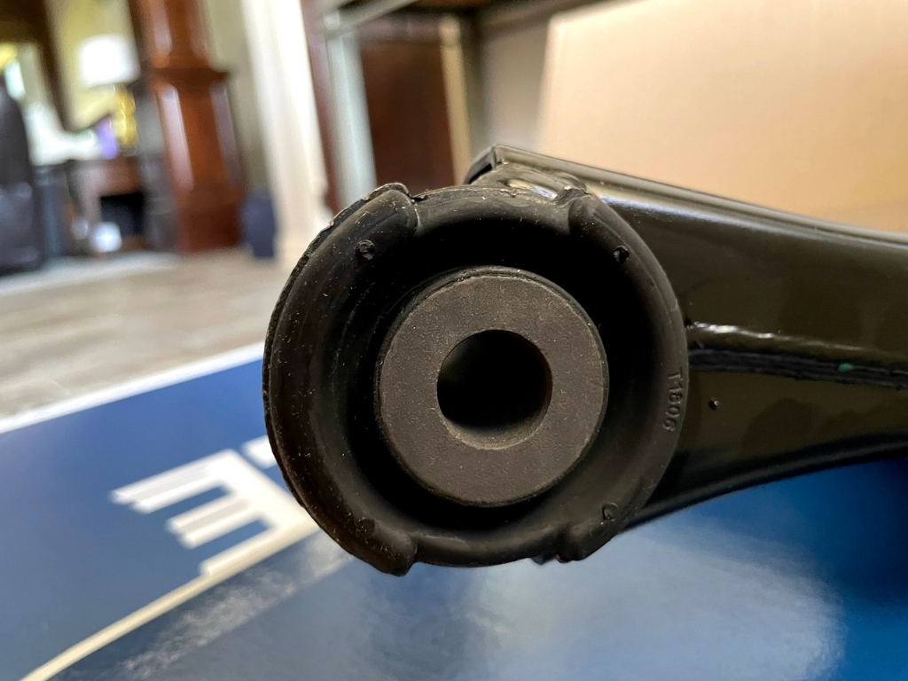

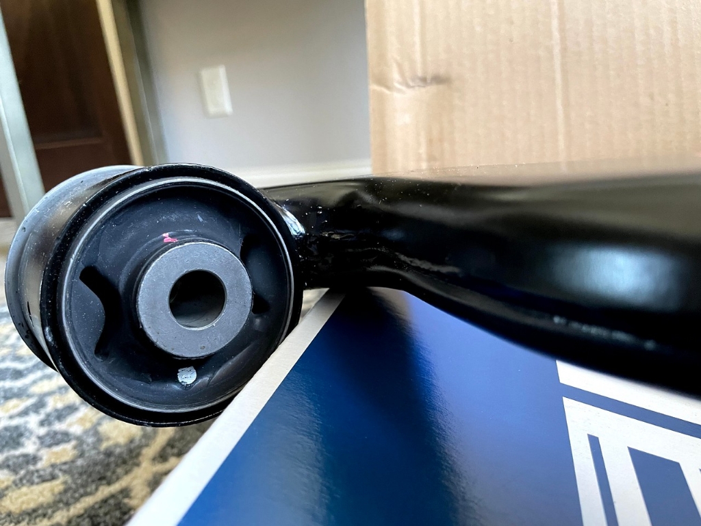

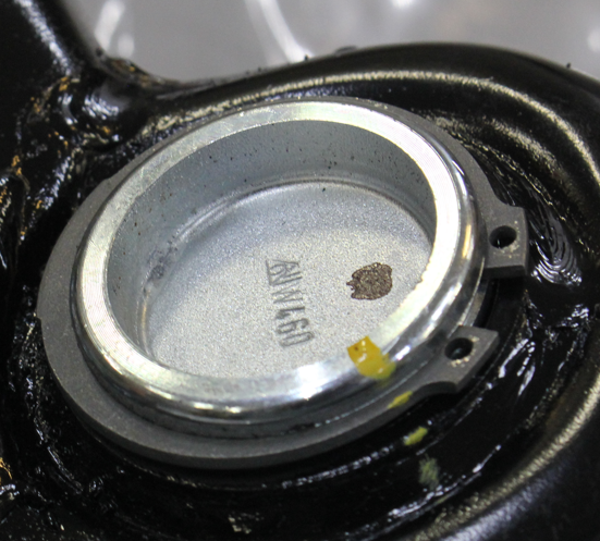

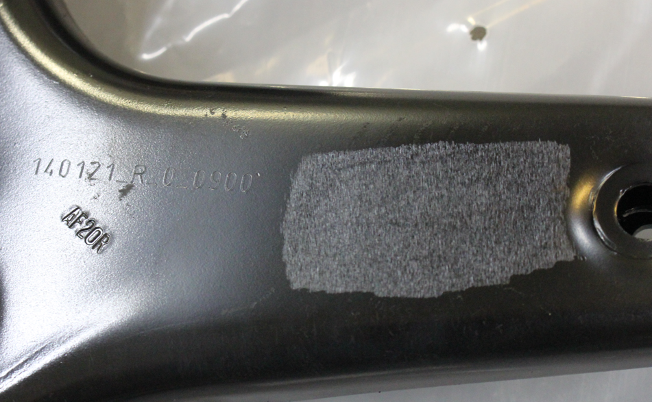

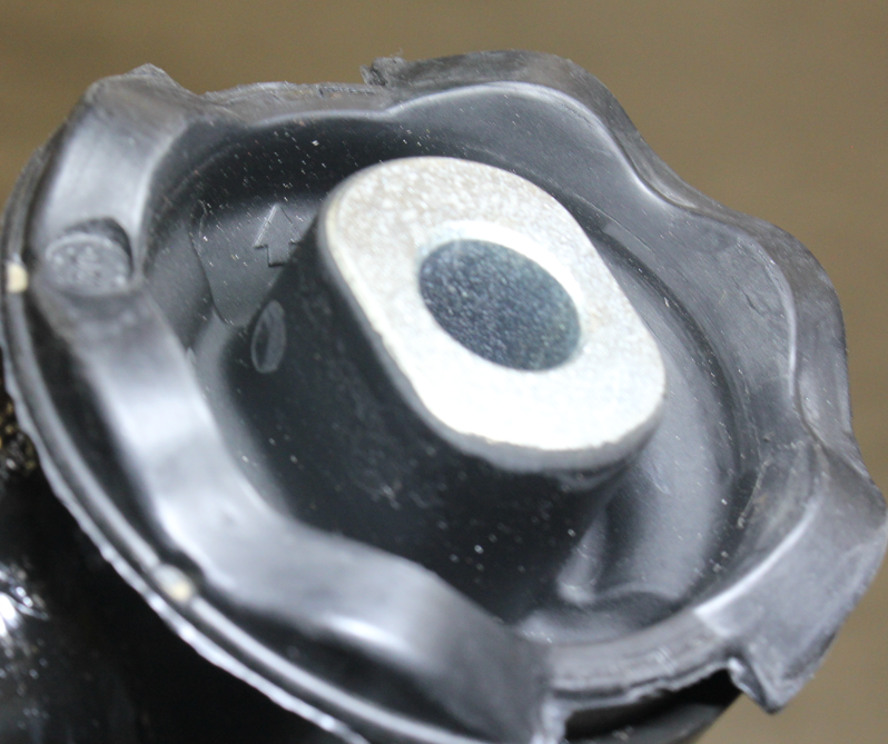

Lemforder appears to sell OEM LCA's that are OE/Genuine with the Land Rover logo ground off. They are even Made in UK. I bought a pair earlier this year, they are available from AutohausAZ and RM European for ~$190 each. I have detailed photos but haven't gotten them resized and uploaded yet. A few sample pics are below. I haven't gotten these installed yet.
