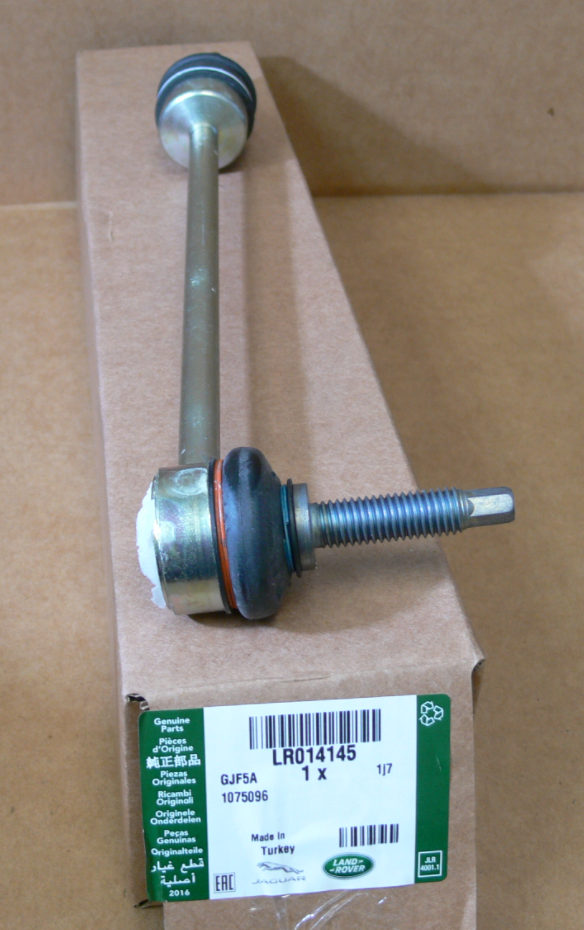

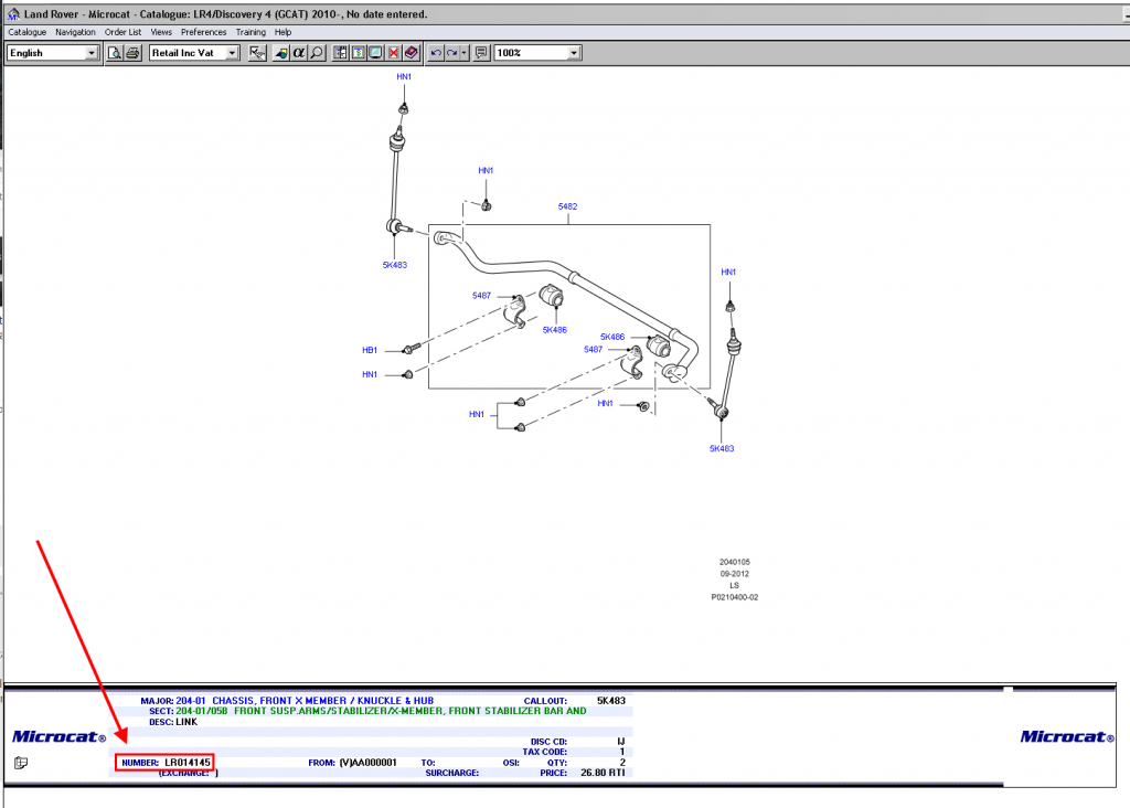

Looks like the sway bar end links are LR part number LR014145, ~$54 MSRP each, $47 from discount dealers like LR Tampa.
Aftermarket Lemforder links made in Turkey are $30-$35 from FCP Euro:

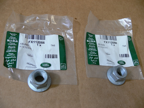

The OE/dealer locknuts are p/n FX112056, about $1 each, 4 required:
It appears the Genuine LR end link may be made in Turkey as well, the Lemforder aftermarket may be identical... probably not worth paying more for OE in this case. And the Lemforder includes new locknuts.
Microcat screenshot:
