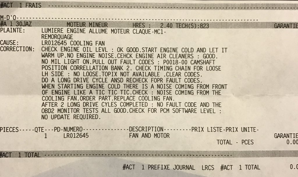

Yes it fixed the sound.
I'm still on the road (Montreal). Will read the service paperwork one more time to give you guys the part number.
AxelR
Mar 17, 2013
860
58
Attaching a picture, so you can see for yourself what was done. Most of it is in English.

Interesting. I would not have guessed a cooling fan. I'm going to send a video to the dealer to see if they have any thoughts.

I'm confused. Was the ticking noise the fan clutch, then you had the timing chain done? I guess it's possible you had the ticking noise then the camshaft code was thrown. Two unrelated issues.
I haven't heard the ticking since those sub 20 degree mornings.
