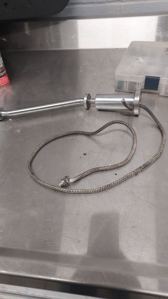

I have a rope attached to my injector removal tool.
A quick tug on the rope and the injector comes right out. Usually no more than 2 pulls.
It's all about the velocity of the slide weight.
