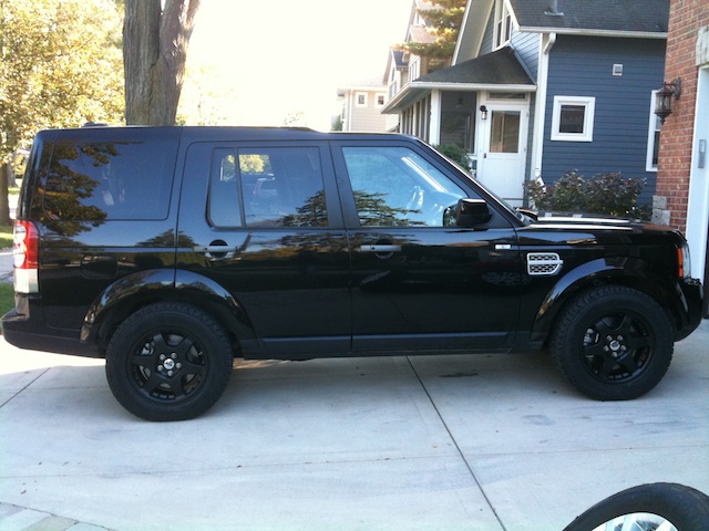

Compomotive on the landie
Here is a pic from my recent install.
suvowner
Dec 23, 2010
164
Hey guys,
Thought I would share a couple pics of my LR4. I just had the 18 inch Compomotive wheels and Cooper Zeon LTZs installed this morning by my dealer. They couldn't get the spare to fit under the car, so I guess I will have to work on squeezing it up in there.
A couple thanks to guys on this forum - to Rob for the Sasquatch rods (shortened about 8mm from stock for about a 1.5" lift) and Luke for the wheels. I think the whole thing turned out great and i cant wait to hit the trails!
Nathan
went wheeling this weekend on my scorpion atr, and they did remarkably well, can i ask how much the comp motive wheels were including shipping and all charges ?? and how long was the shipping time ?? I have the inside track on a set of the 19" goodyear mtrs, but if i had 18" wheels, opens up multiple tire options
