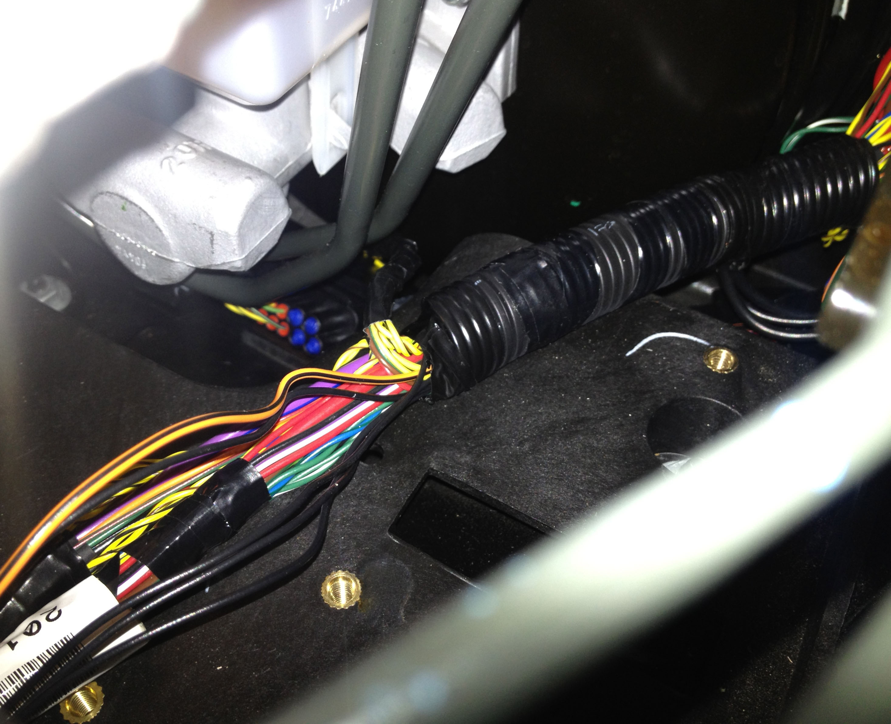

@umbertob Yeah, that took some fiddling... There's a square hole way down in the back that I used to relocate the union of the two plugs. It was originally held together in one of these square holes up in the box but there's another down in the back near the firewall. Its a tight fit but it just reached it so it still is secured to something and out of the way. Hope that helps... I stumbled upon it but its there. Below are a couple pics of the connector I'm referring too. Is this the one you're referring too?

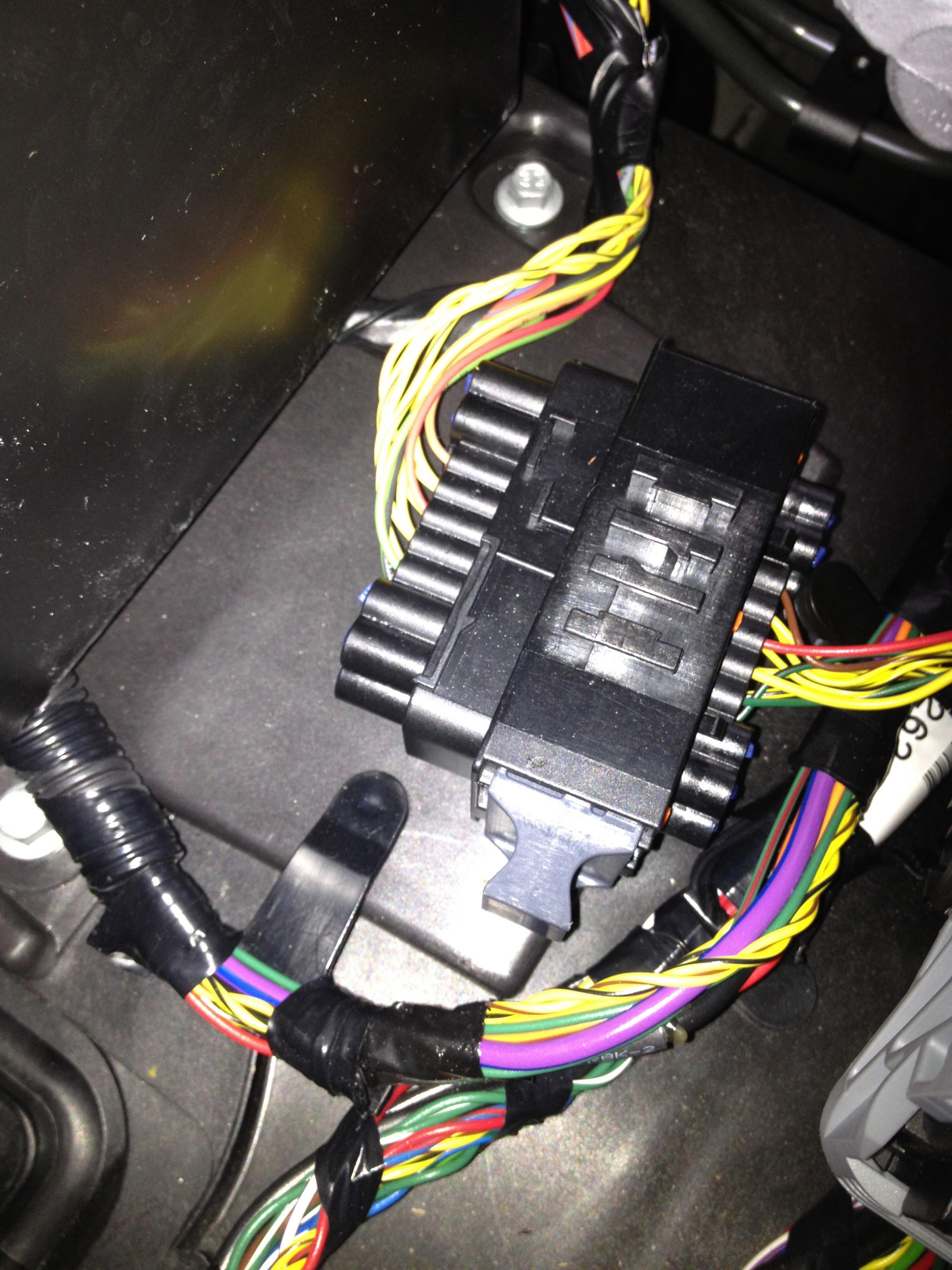

This is the same connector relocated... The connector is down below with the 4 blue dots down by the firewall.

Took another look at these pictures and I think what I did was flipped the plug when I clicked it into the truck. The orientation of the green wires looks to be flipped from the original position. I do remember whatever I did I used the slide-in clip again. I checked the plastic box I removed and the place where the square hole is doesn't have the original bracket so I'm pretty sure I relocated that to the square hole down by the firewall. The slide-in clip gizmo is on both sides of the plug so you can use either side. Its been a while so I'm a little fuzzy on it... If you have trouble let me know and I'll take another look at the real connector in the truck if needed...

Done. Finding the rectangular hole you referred to was easy, getting to it with my big fat hands a whole different story... Anyway, plug's secure, thanks again for your help and the spot-on photos. I found the rubber plug for the cable run through the firewall, that looks like it's going to be just as much fun to get to. :biggrin: Will worry about it when the Traxide kit arrives.
