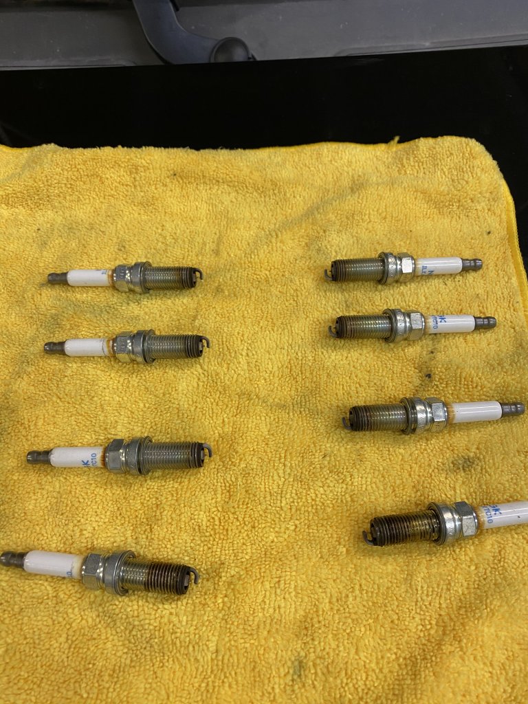

After looking at my plugs, I wonder if I even needed to do the job. Pretty good for 100k miles.

What year is your LR4 and are you the original owner? I notice the plus are 7C10 so either LR made a running change at the factory on the 2011s+ or the plugs were changed at some point.
1,867
2012, but bought new towards the very end of 2012.
I'm the second owner, but I bought at 40k miles and saw all the records before I bought it. These are the originals.
1,412
Interesting. LR changed the heat range spec sometime after the 2010s
