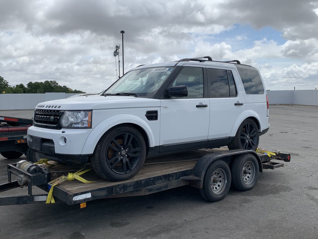

Thanks for the replies! I just called Lucky 8. They sold it to me for $480 out the door shipped. It'll be here Wednesday. I'm leaving town until next Sat but will have Sun and Mon off next weekend to work on it. Speaking of starters. It there a way like old school to jump across the starter and see it will even turn over? I've had a buddy mention that so I would know if its faulty or not. Anyway thanks again!! I'll keep you all posted!

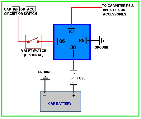

I can help you diagnose why the truck wont start, I just went through this process a few weeks ago.
1. Do you have pressure in the brake system? If you don't, truck won't start.
2. You can test the starter and starter circuit by jumping the relay, it will let you know if the problem is with the ECU or the starter system.
Frankly I wouldn't spend the $500 on a GAP tool before you try a normal OBDII tool... $15 tool from amazon or rent one from autozone.
Test the starter by removing the starter motor relay from the relay box (next to the battery in the engine bay). Under the cover, the relay is labeled "SM"... I want to say it is on the passenger side of the relay bank, close to the front. Pull the relay out.
The plug will look like the blue box on this diagram. Take a short piece of thick-ish wire, and connect pins 30 and 87. Make sure you jump the right pins, or else you run the risk of cooking your ECU: When you connect those two pins, the starter should engage.
No click? Starter bad or bad starter fuse.
Click but no crank? engine seized.
Engine cranks? ECU is not sending a start signal.
