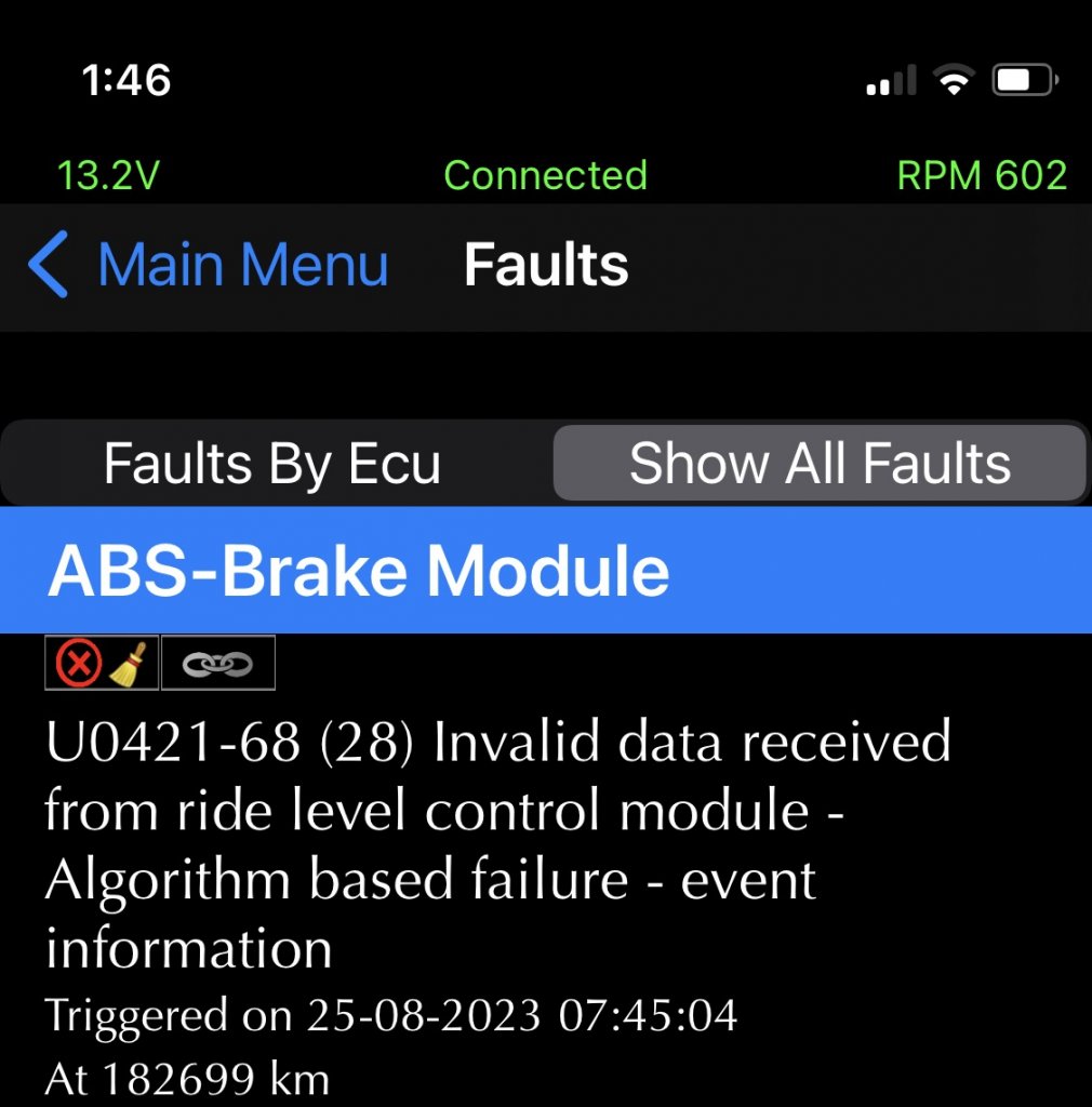

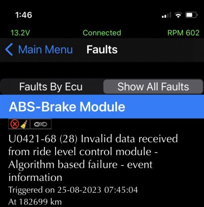

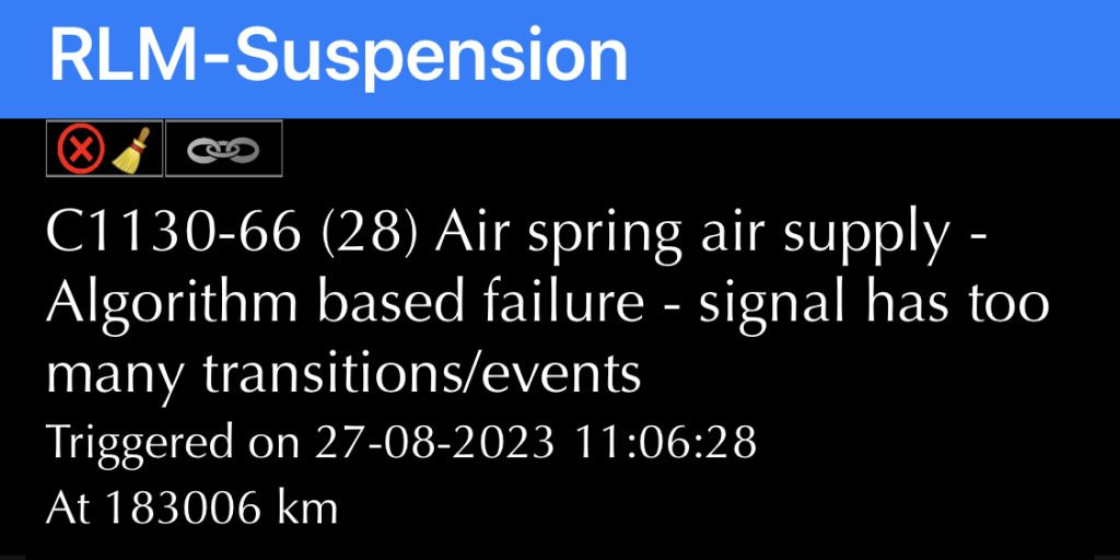

OK, finished my suspension recalibration. First returned my ride height to default with the GAP IID tool, then followed the recalibration procedures. The front recalibration was -24mm and the rear was +17. Will see if it makes any difference.
Also, my fault codes related to suspension are pictured below. The RLM-Suspension fault date of August 27th was off road when I noticed the air leaking from the front left strut.
The Brake Module fault is from 2 days earlier and that was on the road and it may have been when I dropped to my bumps, I can't recall exactly. If/when it happens again I will check faults that day.

That's the same code I just dealt with. It would sometimes pop up every 4 or 5 days, and sometimes more than once in a day. Only difference is mine was C1130-66 (AF), but I've never really made sense of what the code in the parenthesis means on these.
I had already replaced my front struts about 20k miles ago, and my front valve block a month ago or so, and the code was still popping up.
Code seems to finally have gone away when I replaced my rear air struts, and then the rear valve block the next day. Not really sure which one of those did it, but based on a lot of searches it could have been either of those. If I had to guess, I'd say it was the struts. Almost 130k miles on them, so they were probably due.
