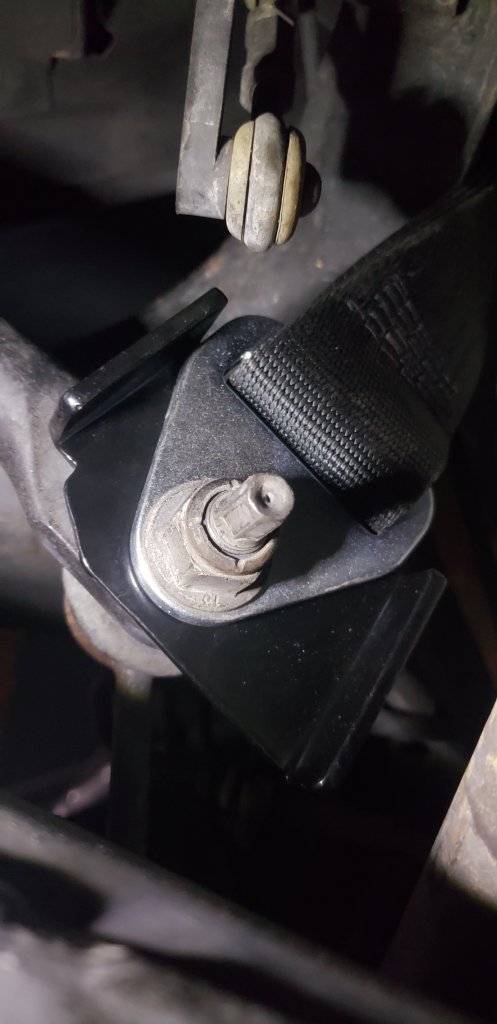

...although one other thought occurred to me that makes me suspect the engineering a bit: the rear strap lower mount. I don't think it's a good idea to mount those to the alignment bolt on the upper A-arm. I'm worried that it's going to make aligning things a real PITA.

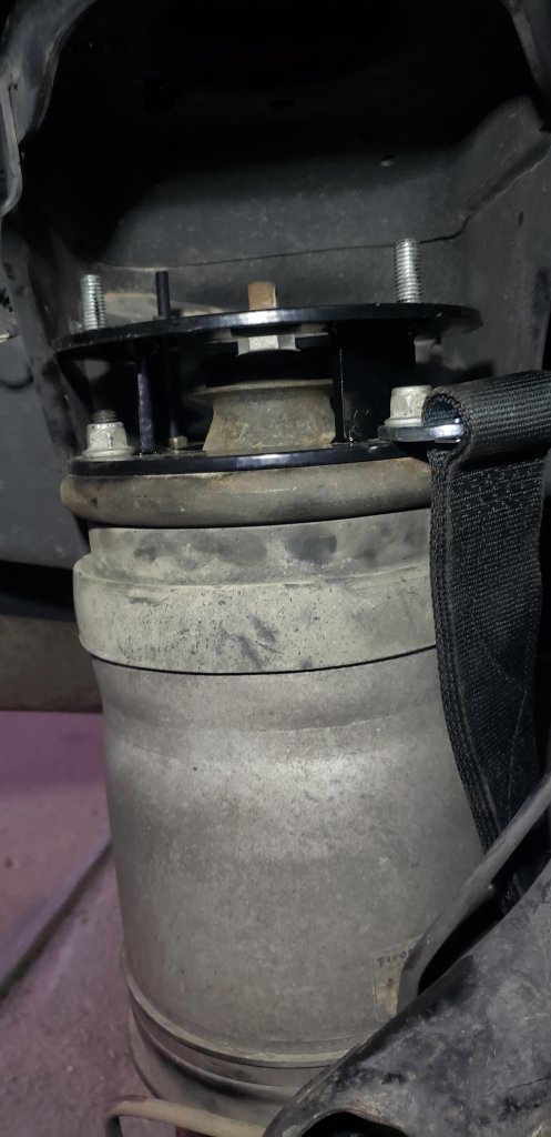

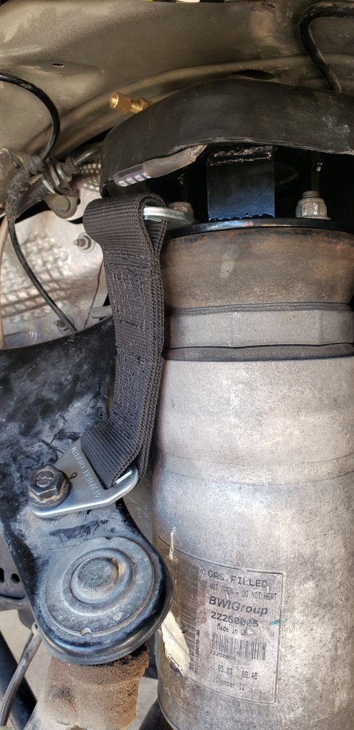

I've been running this kit since October 20, 2020. I've reached out to them about the install as well and I don't agree with them about the limiting straps and placement. A lot of people are having issues with the rear limiting straps at full extension where the straps are rubbing against the wheels and tires, based on the recommended install locations. To me, the recommended install locations actually limit the full extension.
Here's my fix with pictures and I have zero issues since running them.
Front struts: Top of the limiting strap is mounted in between the spacer on the top of the strut.
Rear top: Top of the limiting strap is mounted in between the spacer on the top of the strut.
Rear bottom: The strap runs along the strut and mounts to the sway bar.
As far as calibration goes... if your truck was perfect prior to this install, the 2 inch spacer should be negated with the 2 inch lift rod. If you're trying to recalibrate AFTER the install, the only solution I found was to install a 2.5" lift rod and add 0.5" to each corner during the calibration. Why add 0.5"? Because, when all 4 corners are fully deflated they're actually sitting at oem height. It's impossible to find 18 1/8" and 19 3/8" with oem or 2" lift rods. I've tried... way too many times.
Anyhow, thats what I did and I can achieve "normal" drive abilities and full extension when needed. The limiting straps have less than 1/16th of an inch to stretch in my mounting locations.

The front was pretty straightforward. The rear was a little more challenging to figure out, but works. Over extension happens when the suspension goes beyond it's limits. With the limiting straps it protects or limits the amount of extension. As you can see in the pics with the wheels off and the suspension at full extension there is about 1/16th (just a guess) slack in those straps.
I get full articulation and functionality like oem the way I have it. It still protects it from being overextended. The recommended install, I had to compress the suspension to fit the limiting straps, which reduces the suspension range.

My main beef with the rear straps so far is that I think it's a bad idea to mount one end to an alignment adjuster, blocking it from easy access. I have an appointment for alignment this Saturday, and I'm worried they're going to have a problem with that.
