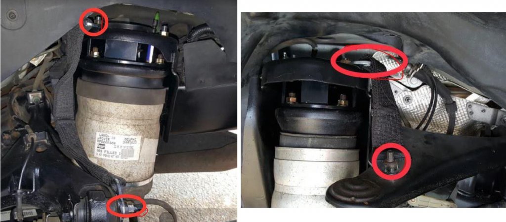

I'd also use the limiting straps. I just downloaded the SYA installation instructions from Lucky 8 and it looks like they still show the strap installation at the top of the spacer (see pictures). I'd try your placement at the bottom of the spacer as you've shown in your photos.
The limiting straps illustrated in the Lucky8 instructions aren't configured at the optimum locations. The rear limiting straps on mine are bolted to the sway bar end links at the sway bar. The front is the bolted between the spacer, above the top hat and spacer. This will give you the optimum droop, similar to regular Off Road mode.

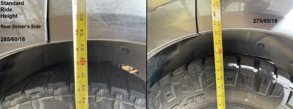

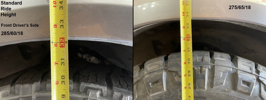

After resetting the "normal" height to +25mm with the GAP IID tool, I also only use the X-lifter for height adjustment. I only touch the dash height buttons to drop to access height when I'm helping my mother get in the car :) and of course access height is now still +25mm over OEM access height. The main reason I bought the X-lifter was so that I could run higher than normal at speed. I was so disappointed when I bought this thing and watched it automatically drop back to normal height once I got up to speed on a long trail. The auto-leveling feature was a nice surprise and that feature alone makes the X-lifter worth the price when camping and sleeping in the back.
I haven't picked up the SYA kit yet. Not sure if I will bother....maybe just reinstall the 285/60/15 Nitto Terragrapplers I had on before and not bother with the extra expense and effort to net an extra 1 to 1.5". The real problem is the idiot who designed 31" wheel wells on these LR4s. I'd love to have the 33s (285/75/16) that I ran on my 2004 Disco with a simple OME HD suspension swap. No EAS to worry about. Of course it also rode like it had HD springs under there and the air suspension is soooo much nicer.

Just looking at the images, are you measuring from the ground to the top of the wheel arch? You should measure from the center cap of the wheel to the top of the wheel arch and just by looking at it you definitely need to recalibrate your suspension with your Gap IID Tool.
Find a flat level ground before you start, leave the truck running with the driver window down, and start the guided calibration. That'll help with your suspension issues.

Yes, those measurements are from ground to wheel arch. Will recalibrate with GAP and then recalibrate the Xlifter too. Will also see what suspension fault code is stored.
