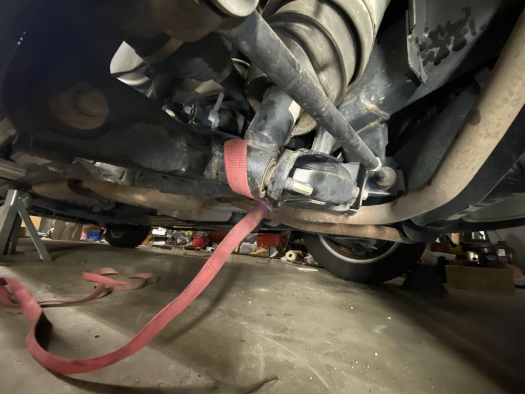

Regarding the rear strut an getting it lined up to mount the bottom bolt, I found that one of my old rigging straps from when I was a whitewater guide helps a lot. I’ve attached a pic here. Basically, I put tension on the strut to pull it in while I used the floor jack to compress it. Stage 1 of lining it up is just to get it close enough to insert a screwdriver or thin rod in once you get the strut in the ballpark. Then you can re-tension the strap as needed, and reposition the jack for the next lift.
