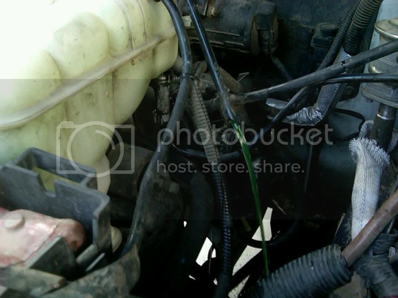

2001 Disco w/140K + miles. The thing is pumping through coolant like its free and dumping it all over the driveway or wherever its running. I found a small leak seeping out the sides of the little block on the underside of the throttle housing and fixed that with some RTV. However, after about 3 mins of running after a start it doesn't appear the coolant is circulating. It gets pushed back into the expansion tank where it fills to the top and drains out the overflow tube:
Its a steady stream that doesn't quit even after the engine is shut off and after reaching operating temp, bubbles out the tank cap as if its overheating. It'll do this until it either cools or runs out of fluid. Guess what usually happens first...

Start first by not driving it. Order a new t/stat and coolant cap and when you have those 2 parts make sure I have your number, I'll call you and walk you thru all that probably needs to be done.
