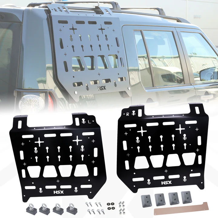

Has anyone worked with the guys over at Powerful UK? I'm looking for any feedback on their products and more precisely, their molle plate system. I'm really digging it and would like to add this upgrade to my rig.

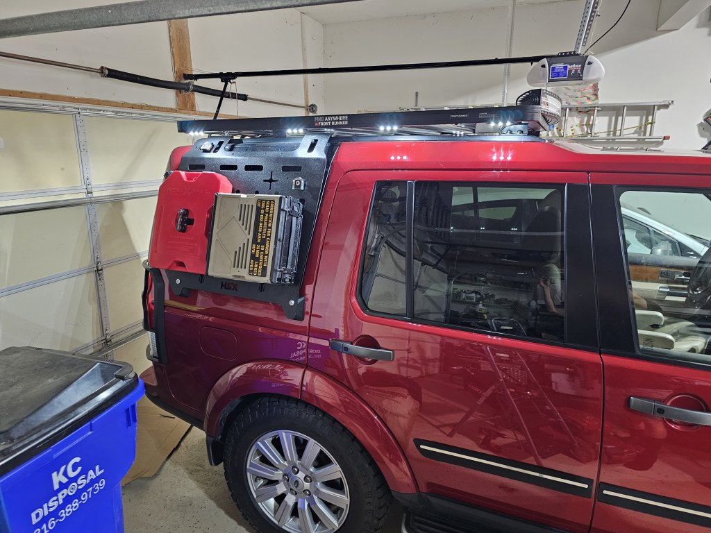

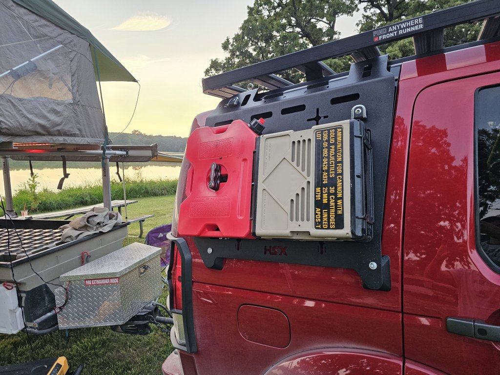

Yes, I have one. Details:
1. Love it.
2. I installed with 3m double sided tape on the bottom brackets (which are 3d printed!), instead of the rivnut option. I have a full rotopax and half my recovery gear on it, and it's been solid on 30+ offroad/overlanding trips.
3. These came out waaay too late. Moving gross stuff out of your rig really helps with space and organization..
4. If you have a roof rack, MAKE SURE it will mount properly.. I've got a Front Runner on the stock rails, and it fit fine.
5. It's big. This is not a cute little plate like on the 4Runner, with everything on mine it still isn't full and has a constant 50+lbs on it.
6. The folks at PowerfulUK are awesome. Call 'em with any fitment questions; they've got some other cool LR3/4 stuff..
LMK if you've got any other questions..
