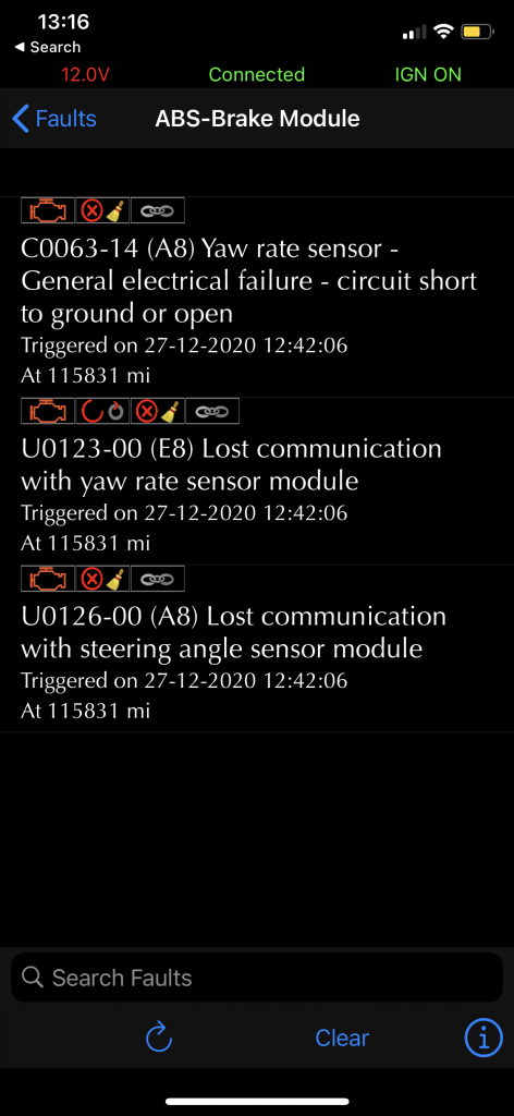

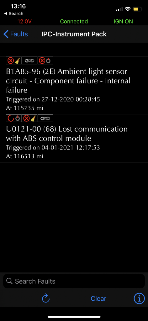

My dash lit up like a christmas tree after driving in snow.

Did you try calibrating the yaw sensor and steering angle sensor already?
I’m pretty confident it’s your battery. I’d say get a new battery and let the codes clear and then drive till you have another problem. I fine the ABS module tend to throw weird codes on my car. The car still behaves fine and no lights on the dash but I tend to get faults like this a lot. What’s everyone’s thoughts?

Use the GAP tool to calibrate ride height. Complete the alignment. Then, under calibration, select ABS-brake module for the yaw rate sensor and steering angle for steering angle.
