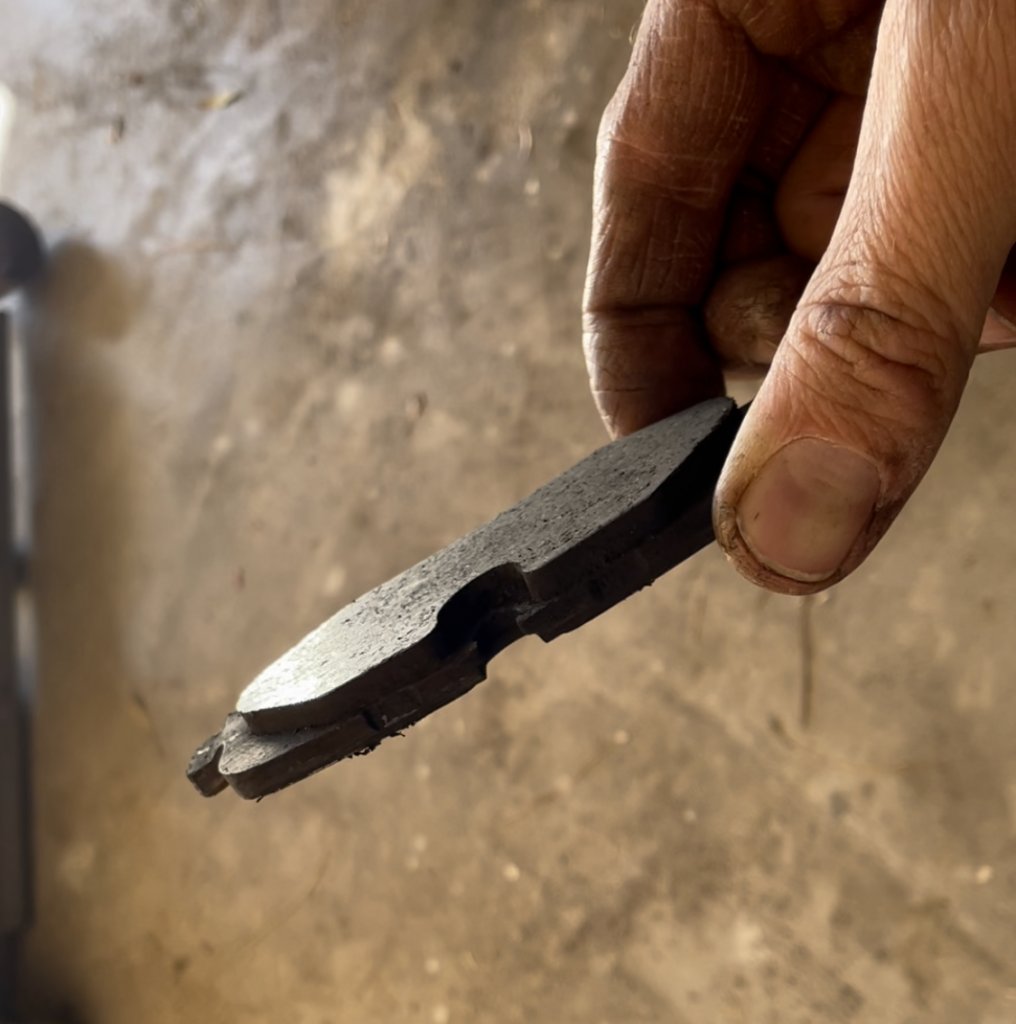

While at the dealer they told me my brakes were at 1 and 2 mm front and rear. I declined the service and just finished the rears at home today. The pads were no where near the 1mm they said, actually more like 1cm. I thought it was weird that the brake wear light wasn’t on if they were that bad. I don’t know if I should be surprised that they would just straight up lie about something like that but it doesn’t give me any confidence in that dealer.
