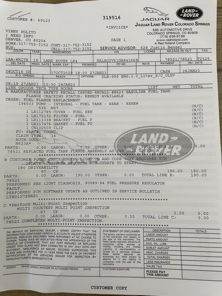

Sold our 2013 LR4 (never had any gas smell so never got the recall done). Bought a 2016 with 78k a few weeks back and it smelled like gas when I filled it up and was throwing P0089 code, which I read is fixed with a PCM update.
Took to dealer and had them update PCM and complete the recall. During the repair they found bank 1 oxygen sensor 3 was faulty and replaced it under manufacturer warranty (don’t know what that means). See invoice for recall parts replaced.
My wife drove it home and the engine light came back on. I ran the codes and both P0089 and P008a fired. Can’t clear them. Just filled it up and it REEKS of gas in my garage now. Left LR a message since it is Sunday. I’ll update you all on this saga.
Part 2: Pulled truck out of garage and noticed a big puddle of gasoline on the garage floor. Parked it in the driveway and it was dripping from the tank around one drop every 5 seconds, so I stuck a drip pan underneath. Got ahold of service manager at LR Colorado Springs and he sent a flatbed to tow it in.
After they dropped the tank they replaced the fuel pump o-ring on top of the tank. They drove it around a while to ensure no leaking. Leak was resolved but check engine light wouldn’t clear. Dropped the tank again and diagnosed faulty in-tank (low pressure) fuel pump. Offered to replace for cost of part and no labor since the tank was already dropped for recall issue.
