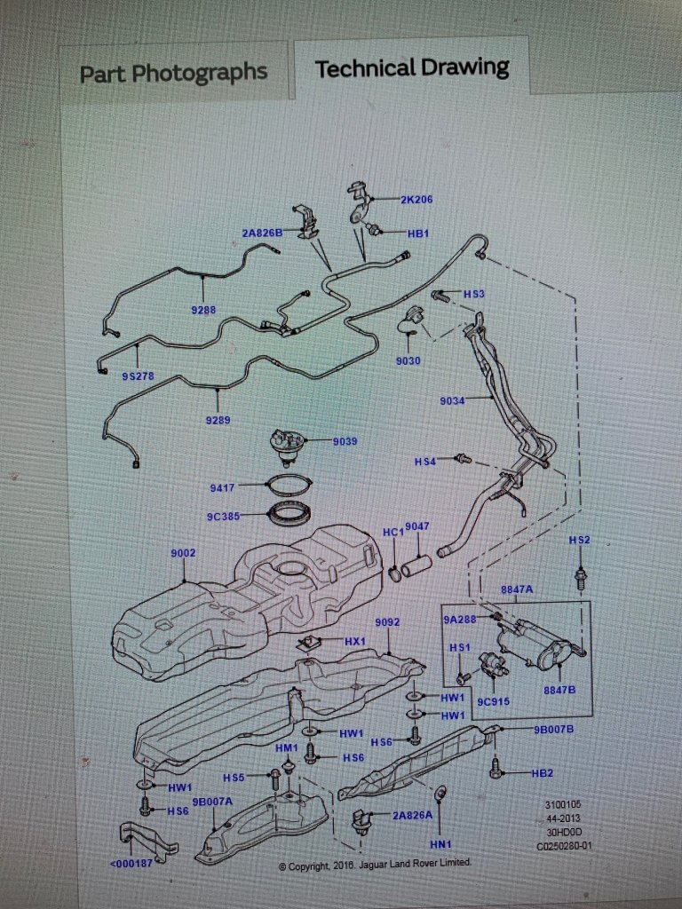

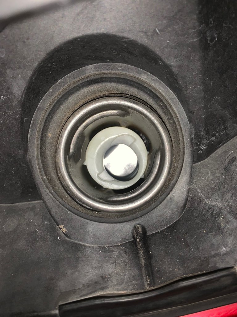

And when I look at the 2015, this is what I see from the top down, I don't see anything that looks or feels like an o-ring.
Do I need to remove the fender liner and look from underneath to find the location you are referring to?
And I have had this idea before, what if, this is much ado about nothing and it's really just that few drops of gas from the dispensing handle dripping down into that drain channel on the outboard side of the cap and then draining down that hose to the fender, where it disappears, I assume to be open to the atmosphere - seems unlikely that there could be enough fuel there to cause this much stink, but ??

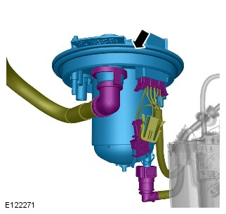

Part 9039 is the fuel cap. On the bottom, there's the evap vent hose that snaps onto the cap.
This evap vent hose is exposed to raw fuel. Therefore, if that bottom hose o-ring is leaking, raw fuel will enter the charcoal cannister.
Top left purple part is the vent hose ( arrow pointing to it) . As you can see, exposed to raw fuel.
Hope this helps.

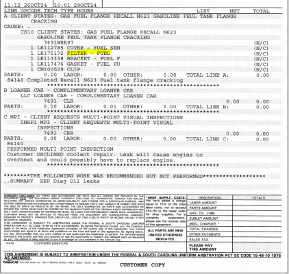

I had the recall and found it very difficult to get a service appointment with a loaner car and the next day when I was about to call the dealer GM to complain, I hatched a better plan. I called service, again, and noted that I now smelled fuel odor from the rear (Ok, I was refueling it, but they did not ask WHEN I smelled fuel) and amazingly they prioritized me and got me into the dealership the very next day! Halleluiah. The service included rear filter replacement, which was on my to do list, so I was very happy. To top it off, they gave me a Defender loaner over the weekend and my wife decided she preferred her 2016 LR4 as the spare tire interferes with visibility for her (does not trust the camera).
Recall campaign noted on the attached service record clip
