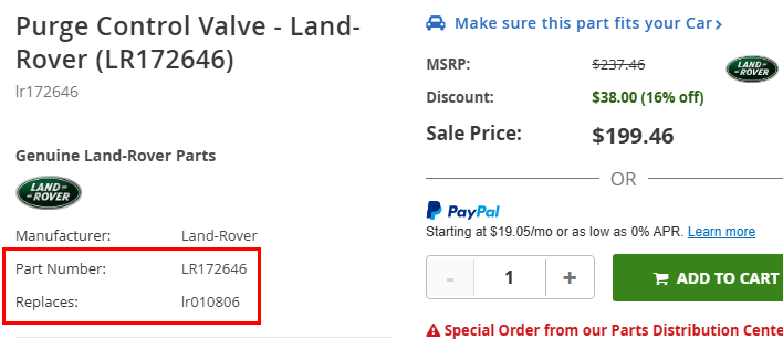

Big Sky Country
LR010806 was an older part number, superceded to LR172646. $200 from this JLR dealership.
However, the other 2 part numbers above are also "Purge Control Valves" and I don't know which one people are replacing to fix the fuel-filling issue.
That is a great deal, thank you. I did notice there are quite a few PN's but the way I'm looking at it is hopefully there is only one Purge Control Valve per vehicle mounted near the engine valve cover and the wizard on that site verified it fits my year/model. I did a visual part and picture match for LR010806 so as long as the website I was looking at had correct information then then LR172646 is the latest revision. That is something I didn't think about with the Ebay option. That used part while functional and inexpensive could be outdated where new fixes are built in later part revisions making it stronger. At least that is what I'd like to think, they could potentially do that if they wanted to lol.

For the Purge Control Valve replacement, there are a lot of options on the internet. How much do I want to pay is what it looks like but I want to buy good enough for 100k mi.. There are replacements on Ebay for $50, one of which had a Bosch branding which is what I have, but its unknown miles. Then the dealer wants $400 + $50 in gas to get there for new lagit Land Rover part and Amazon has it for $300. Trying to decide where to buy it. Where did you get your Purge Control Valve from, does it seem like a quality part?
LR172646
$112 from checkered flag Land Rover 1/2023, but that was the price for the old part. I ordered during the update and they honored the old price.
10806 is an outdated part, not just an old number.
