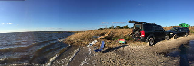

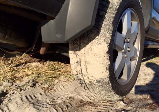

Took them out on the beach last weekend and they did fine. Not the typical long beach drive this trip so I can't give a 100% review, but they did what I needed though soft patches. I wasn't going far enough to air down.
I do enjoy sitting on the tailgate with a beer, parked on sand, waiting for the sunset...
