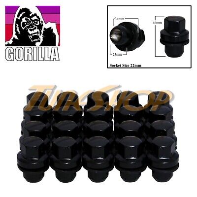

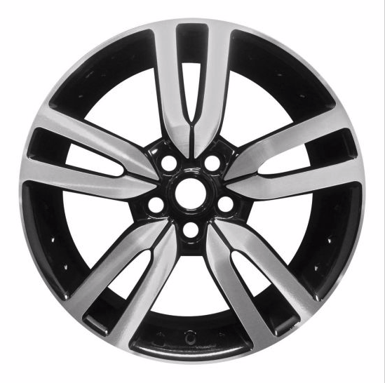

Based on the above post I purchased those exact Gorilla nuts on eBay (I followed the link) just three days ago and they are an exact fit for my 20" 10 spoke wheels (photo attached). I also have the 19" wheels that came stock and are currently on the car but I have to assume they use the same lug design. They have to be a mag seat design (with the washer), not spherical or cone. I also received them in record time for an eBay purchase which was like 2 days. The only negative is all 20 arrived loosely in a box without any internal wrapping or protection. They were all hitting each other. I haven't looked at all of them yet for any chips or scratches but I can't believe Gorilla manufactures and packages them that way. Ones I've purchased in the past from Gorilla were all individually packaged in sets of 5 in those impossible to open plastic containers.

I purchased a set of chrome Gorilla lug nuts off eBay from seller "tuneshop" (item #181000940211) and they are solid lug nuts with no cap. They have been installed for 6 months now and I haven't had any issues, would definitely recommend over the OEM ones. I replaced several OEM lug nuts due to swelling and decided that I don't want to risk being stuck remotely and not being able to remove a wheel due to a swollen lug nut.
