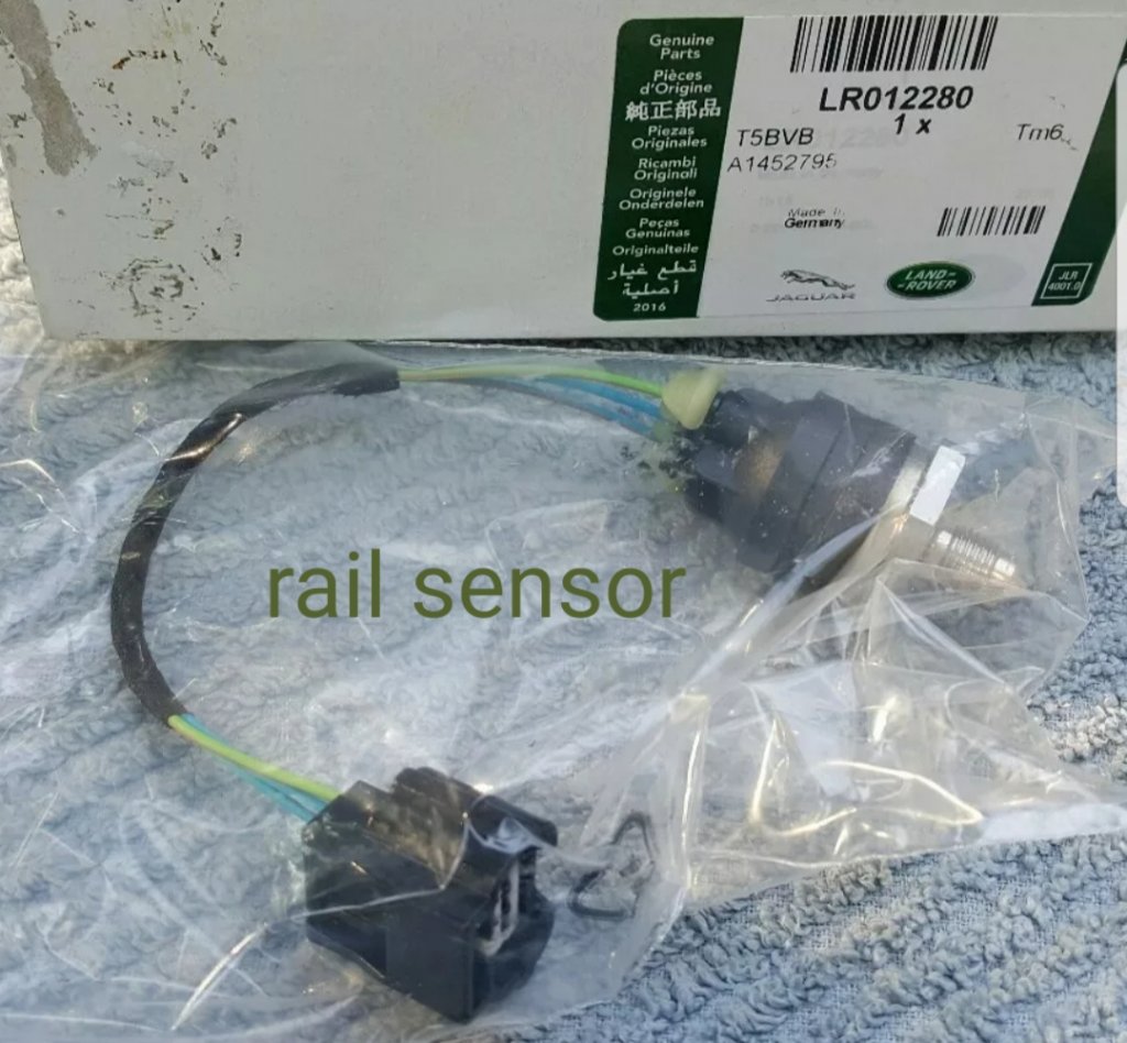

Rail sensor, LR012280, is located on passenger side at the firewall just behind the cylinder head. A crows foot size 1&1/16 fits the sensor just right. Run a few extension on a ratchet from the front of engine towards the back in between valve cover and battery.

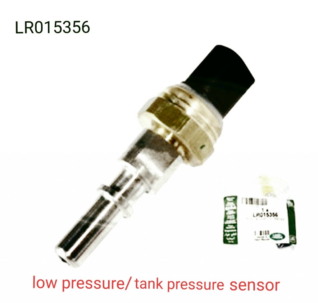

Low pressure sensor LR015356 is on passenger side of transmission behind a tin shield. Looks just like it does in the video. That one is not as fun to r&r. I opted to just unscrew sensor from the fitting versus depressing the quick disconnect on the line.
