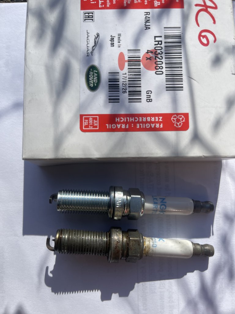

Found the problem: Bad Coil. The cylinder 1 plug did have a little oil on it but it didn't make a difference in engine performance after putting new one in. The moment I replaced the coil pack (on cyl 1), stumbling & hesitation stopped. Swapped around with a spare twice to confirm. These coils I purchased from AB less than a year ago so rather surprised they failed so early. They don't have the same FoMoCo insignia as OEM. Leaning on replacing all with OEM, as who knows which of the other 7 will fail shortly.
