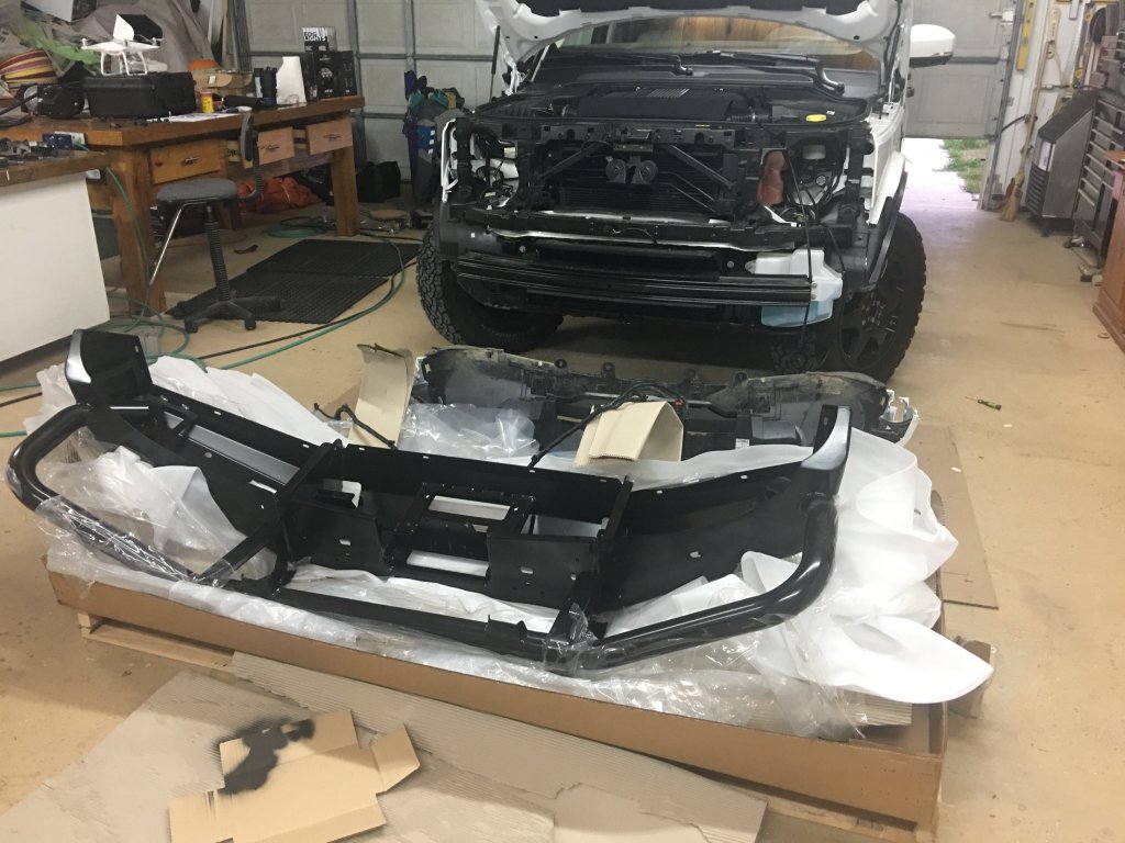

I'm in the middle of installing the ARB bumper to my 2016 LR4 with the ARB Intensity Lights. Testing the lights before final install tomorrow I can't get the ARB lights to come on. I set them up for positive switching but thinking maybe the truck is set up for negative switching? I have power to the relay but no power from relay to the lights.
Anyone know if the newer LR4s are NEG or POS switching? Anyone else install the ARB lights? What a pain to get through the firewall on these trucks especially on the late model ones. Can't wait to have this project done where I'll do a full build page of everything I've done. Quick shot of where it stands as of today.
