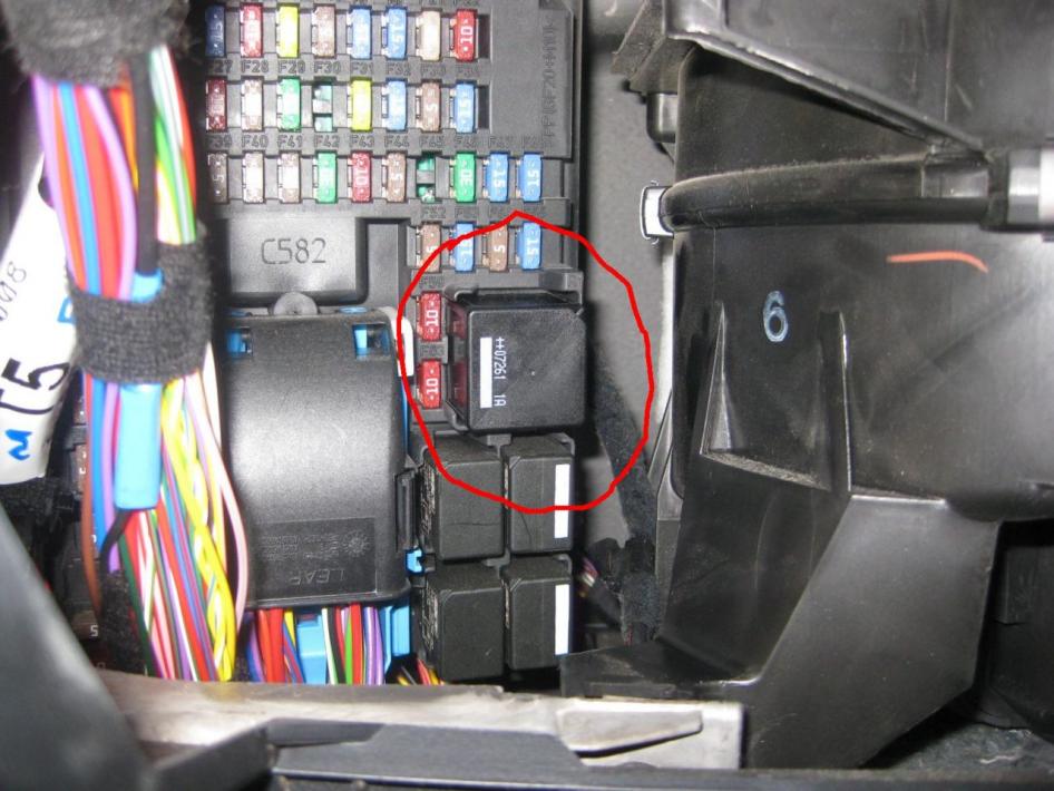

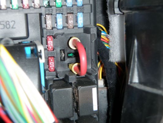

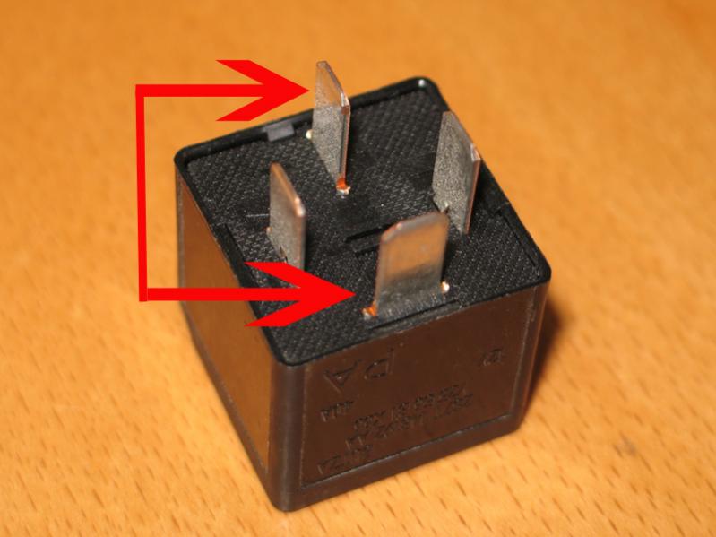

You can remove and bridge the relay for accessory sockets in front passenger, rear passengers console and trunk / loadspace areas (the cigarette lighter socket on driver's side can be jumpered as well, but it's on a different relay.) The relay is in the passenger compartment fuse box. Instructions here, same exact trick worked on 2006-13 RRS and 2005-2009 LR3:
http://www.rangerovers.net/forum/9-...12v-sockets-trunk-rear-seats-console-how.html
PS: It occurred to me that you need to be a registered member of rangerovers.net to view the attached photos, sorry. Will repost them here shortly for easier reference.
PPS: First photo shows location of relay (circled in red) on the passenger compartment fuse box behind the lower glove box. Just pull it and it will disconnect (it helps to have Cinderella hands as clearances are tight back there for chubby fingers...) Photo # 2 shows relay removed and 10 to 12GA wire bridge with spade connectors installed to bypass the missing relay and permanently feed 12v to the accessory sockets. Photo # 3 shows the removed relay and arrows pointing to the contacts that need to be bridged on the fuse box.
