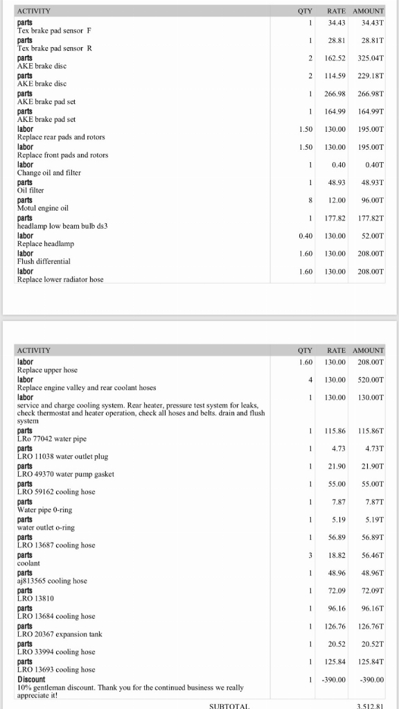

i'm doing the new ball joints when they go. The rest of the work will be done tomorrow and i look forward to the next 80k miles!
ttforcefed
Dec 19, 2010
650
201
And the work is done. I went with akebono pads and rotors.
