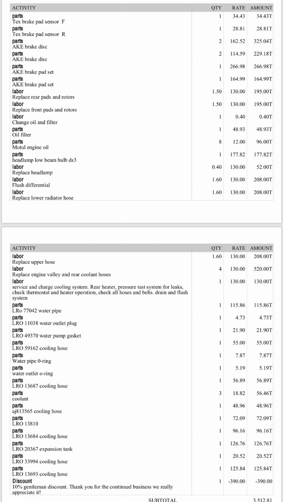

I'm getting my 2012 LR4 back today from a 80,000 mile service done by a good independent LR shop.
In addition to the key fluid changes, I replaced the lower control arm assembly as bushings were shot, water pump replaced along with crossover pipe (small leak in both). There was also some sort of pressure release valve unit that was loose and making a lot of noise that was replaced.
Pretty hefty bill ($4500) but considering it has gone 6 years with only basic maintenance, it doesn't feel too bad. They told me that owners should expect to spend about $2600/yr on average on maintenance on 'modern' Land Rovers - seems high to me but there it is.

given all the work i have had done i though wld be good to update this thread for anyone who is new to this. If you are buying one of these this is the stuff you want to be aware of and just replace if any doubt (outside of timing chain):
Y pipe
Rear heater valve pipe
Tstat
Water pump
Lower radiator hose
Brake vacuum pump
PCV bleeder hose
crankcase breather diaphragms
