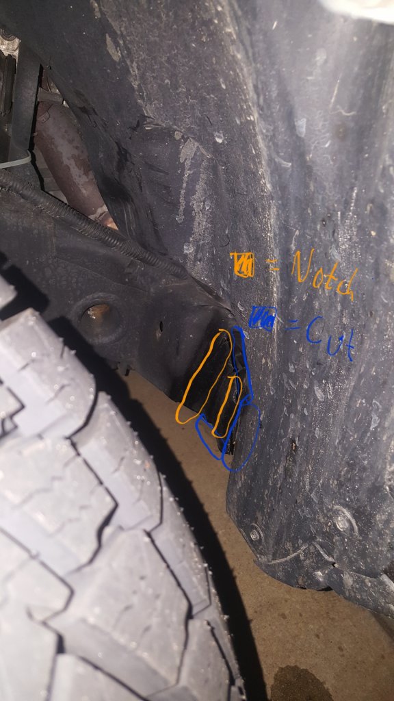

The early LR3 had that bolted on... Once you remove it then it looks like the LR4 when cut off.
Of course! Please see attached. Basically, I cut the top and bottom support, and cut a 1/2 inch section out of the external side. Then, I notched the far side and just pounded it over. It still have a ridge down the center, so I notched that as well and then pounded it flat. Painted it black and called it a day.
On a side note, I re-routed the rear heater lines, but not over the wheel well. I was able to route them behind the body mount and sway bar bushing, then behind the air strut before finally attaching to the rear attachment point.
Can you post a pic? Thanks
