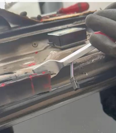

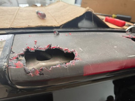

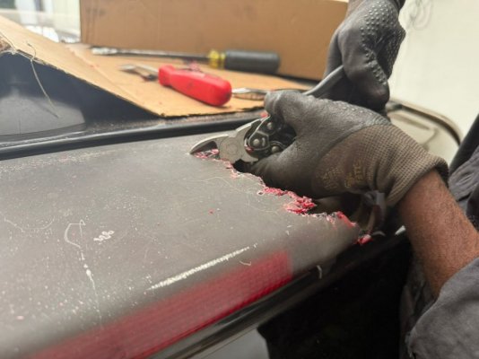

you basically have to break it up in pieces to remove then spend some time removing the adhesive [kid of similar to windshield adhesive]

Thanks @powershift - that was why I was asking but there is some pretty good advice here and @D_Walt posted some great photographs.

I think, as @ugmw177 commented and are illustrated in the photos from @D_Walt - I will need to cut the plastic up (carefully) and then strip all the old glue off. That seems to be where the artistry is....
