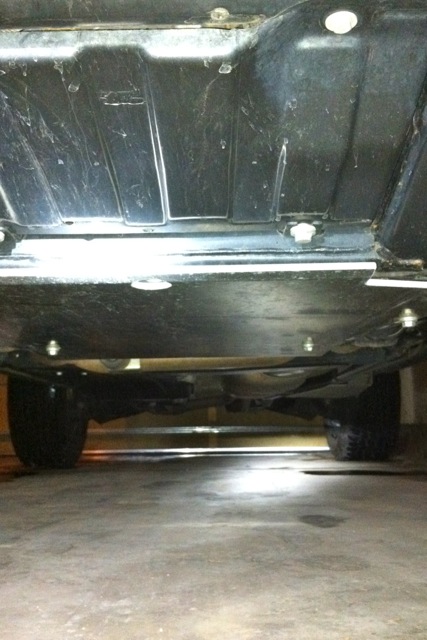

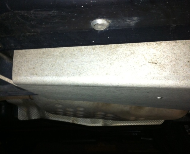

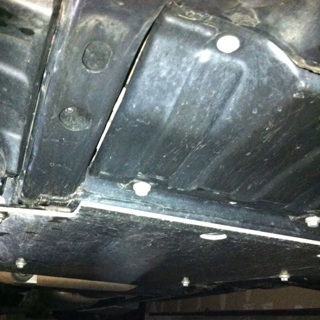

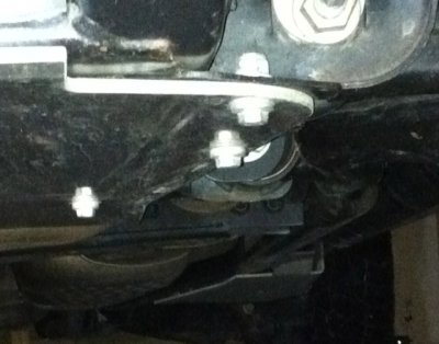

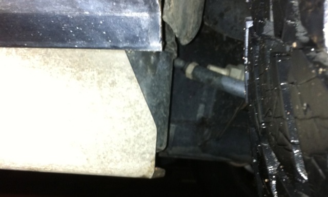

Sorry to jack the thread, but I notice you list a sump protector and air compressor guard. Where did you get these and do you have pics? Also, how are those 275s working out for you? I pulled mine off because of the excessive rubbing.
aesopian
Jan 1, 2010
51
I've been happy with both and the best part is less worry. I have felt the sump protector scrape once over dirt. I haven't gone over anything to affect the compressor protection since it was installed. Everything was purchased and installed through Flatirons Land Rover in Colorado. I don't recall the price, but I recall not experiencing sticker shock.
The photos are not the best, but it gives you an idea of how everything looks. The compressor protector sits below the sliders about 2 inches. A little ground clearance is lost, but it is fine.
I popped open the hood this weekend and eye balled where the Traxide would sit and tried envisioning how everything would look. Decisions, decisions on what to purchase next.
