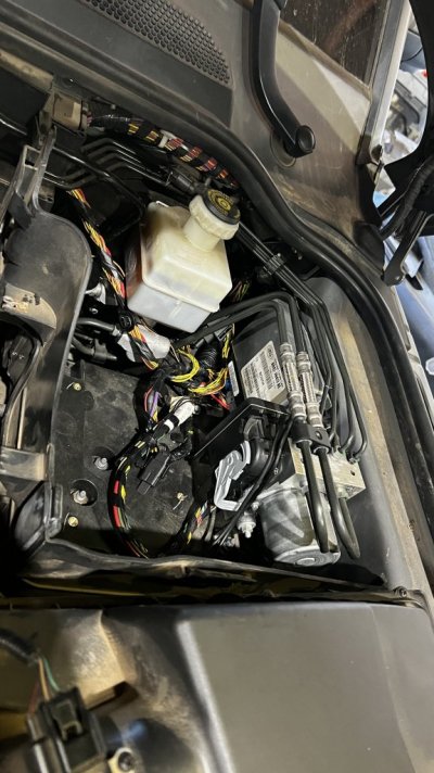

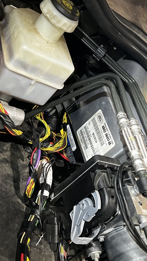

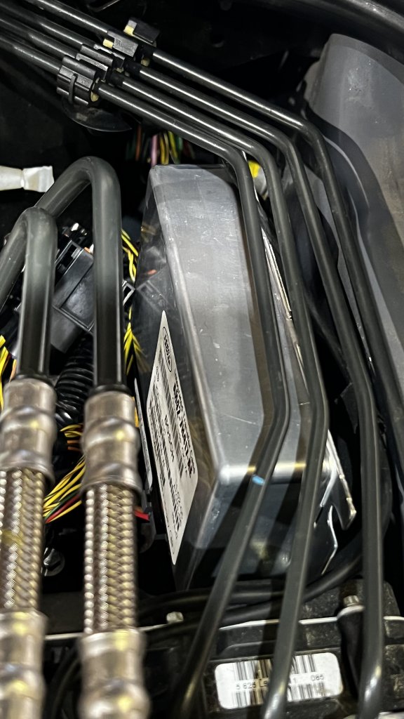

I ended up doing this mod to my buddy’s 2011 LR4. Worked great. I repurposed the horn bracket by flattening the mounting points to marry up with the mounting points of the TCM.
I relocated the horn on the aft-inboard side of the battery box.
Thanks for the insights!!
