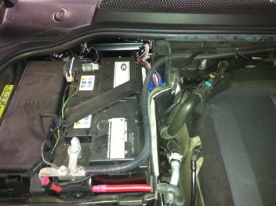

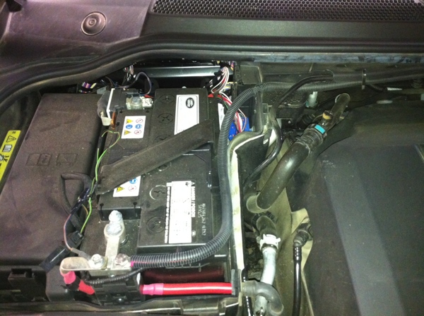

I think drivesafe answered your question, but here is a photo as well.

Here’s a tip, do not connect anything to the negative terminal of your D4’s cranking battery.
You can connect to the positive terminal as in ndrenfro’s picture, but absolutely nothing should be connected to the neg terminal.
The reason is that there is a device connected between the cranking battery’s negative terminal and the earth stud in the side guard.
This is used to monitor the battery and you have the potential of causing problems if you connect to this terminal.

thanks drivesafe and ndrenfro!!, this was just my question to resolve with the picture, to connect or to not to the neg terminal of the batt!
