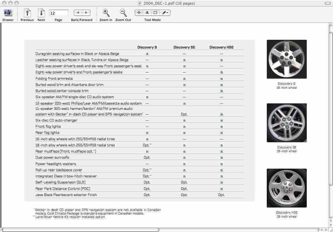

Also, did you happen to see my question above that asks what are the more specific differences between an S and SE model? Wondering if you could weigh in on that too. I thought S models had vinyl seats but then I am seeing some advertised with leather (?). Also, do S models come with 16" tires and SE's with 18". Looks like I can save money getting an S model but I am trying to understand all the goodies I will be giving up.
Thanks again! A.J.:stupido3:
Strange about the leather in the S model, according to the Land Rover brochure, and the S comes with 18's.
See below and/or go here for model information (click on the Discovery tab):
http://www.landroverusa.com/us/en/V...ed_Pre_Owned_Overview@__link__InfoBlockLink_6

jmrivera, great info there... sorry it took so long to show, the forum software required a moderator to approve the post (helps keep spam down)

Jonathan, that is a great chart you found- very useful. Thanks for finding and posting it. How's that '03 working out for you so far? You got all the bells and whistles on that one, didn't you? I hope it's bringing you much joy!
