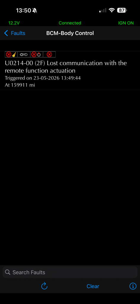

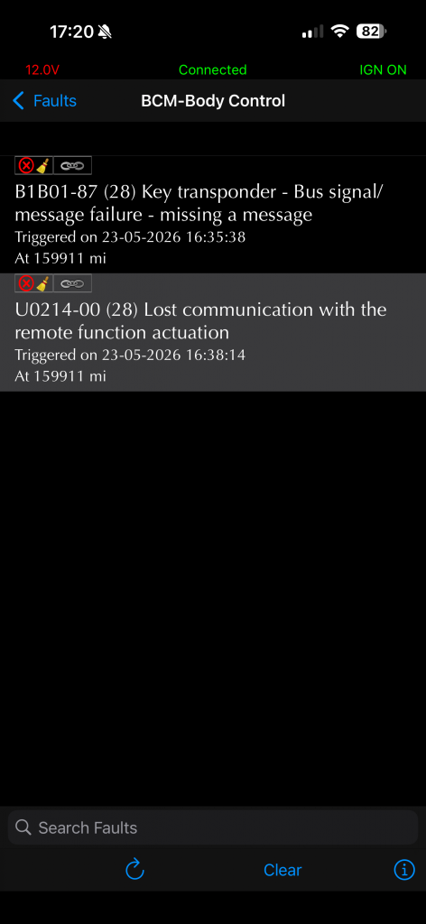

MY IID tool gave me this error btw, for future searches. U0214-00 (2F) Lost communication with the remote function actuation
