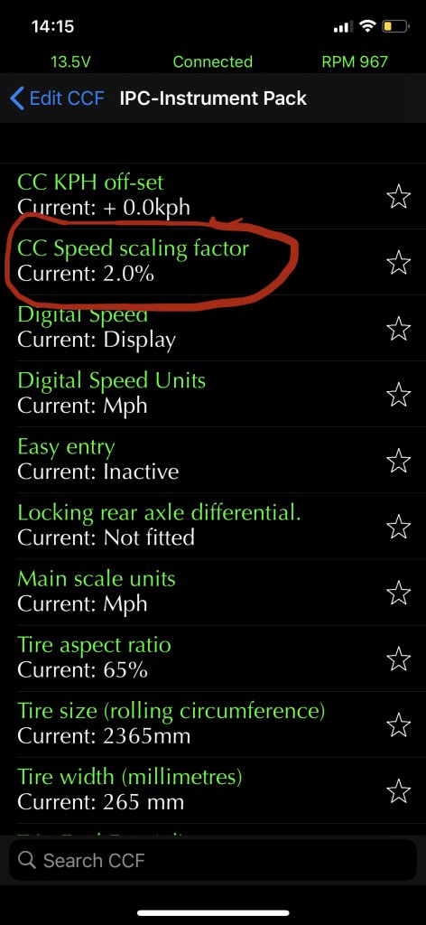

Odd. Assuming you have the same tires as me, can I see your settings for the IID tool in the instrument pack menu regarding tire size so maybe I can spot if there’s something entered in wrong?
my tire size is 255/60/19. but i can post pictures tomorrow for comparison anyway.

Did a freeway run after adjusting the rolling radius, still at 60 MPH gps says 64. Need more suggestions.
Anyone played with speed scale factor? Could this have something to do with it?

It might be that speed factor that I am thinking of. Whatever it was, I do remember it incremented in small, whole numbers (1,2,3,4) etc. IIRC, I dropped it down to an entry of 1.
Wish I could be more help, but it has been years since I did it and as I mentioned, I can't log in to the truck to check right now.
If the speed factor doesn't do it for you, shoot me an IM and I will check when I get my IID back in hand next month.

If someone could tell me how to address this too, I'd be grateful. Currently running 275 55 20s, and at an indicated 75mph, i'm doing 81mph according to GPS, which puts me in reckless driving territory in the great state of VA. Since the limit in question is 70, this is an issue.

Well I raised the tire size MSB IPC to 33 and found out it was more off, reading even slower, so just to experiment I lowered it down to 30 and boom it was spot on. Apparently lowering the size of the tire on tire size MSB IPC makes your speedometer read faster.... even though making the tire size smaller should make it slower...... I don’t understand it, this car never ceases to amaze me. I’m just glad it’s over and I don’t have to worry about it anymore. I’ll send a screenshot of my settings tomorrow so anyone else with 265/65R18 can copy it down and calibrate theirs.

That's awesome - please post if you can. I can recreate what you did with my 275 55 20 size and be close, if not spot on.
