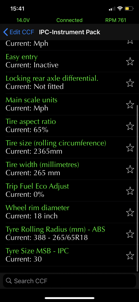

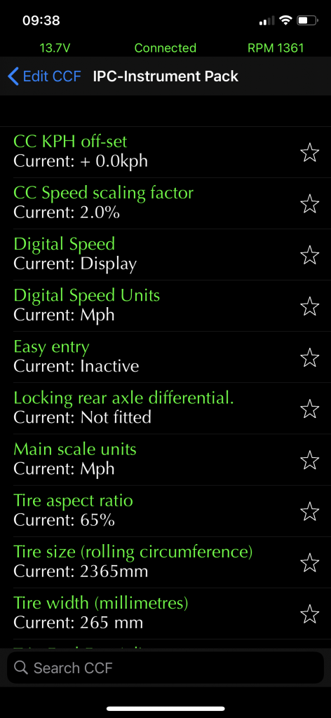

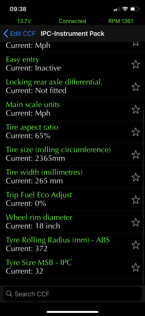

Here they are. My tire size is 265/65/18 so if your tire size is different this most likely won’t be accurate with your real speed.

View attachment 11764[/QUOTE]
Sorry don't mean to hijack here, but are you really able to actually input the wheel/rim diameter into the vehicle' system?
And if so then should I have had my dealership update this data in my LR4 when I went from 20 inch rims (that came with my lux) to the standard spec 19 inch rims?
Because now I am wondering if the system actually takes the entered wheel/rim info into account (along with the tire' info) and adjusts certain parameters (maybe the suspension tuning, etc) due to the varying sidewall heights between the 20 and the 19 inch rim/tire combos.
I mean, the ability to feed the system this info is gotta be there for a reason, right?
